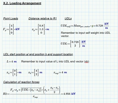

Good Evening All,
I am currently in the process of putting together a simply supported beam bending sheet and I was wondering if anyone had any tips of how I can proceed. As you can see from the attached sheet so far I have got the following:
1.) enter section ID to obtain the properties.
2.) enter point loads and location in the vectors
3.)enter UDLs and start / end points in the vectors.
4.)Calculate the reaction forces.
I am now stuck when it comes to the shear force as a function of x. ideally I would want V(x) so i can integrate for the bending moment. From the examples I have seen online alot of the times the shear force is input as a piecewise function (IF x<a... and so on).
Is there anyway so I can get a general expression for shear force that will work no matter what the point loads are / shear forces are and so I don't have to type it out fully each time. Also as this sheet may be used by others I don't want them to have to type in the equations incase of mistakes.
My current thought process would be to possible calculate the shear force as two function V1(x)=point loads and V2(x)=UDLs. I could then define V(x) as the summation of the two to obtain an expression for V(x). But I am open to suggestions and thankyou in advance for any help.

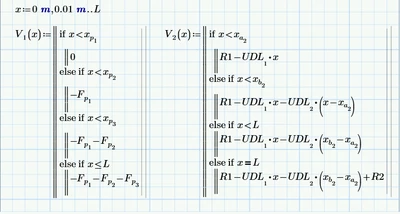

Hi Terry,
Thanks for the example sheet, do you have any additional information about what the sheet is doing at each stage. I am relatively new to the software and any additional information would surely be appreciated.
Currently I have gone for this approach and obtained the correct shear force diagram but I would be interested to hear more about the sheet that you have provided.
Best regards,
Callum
for example I can't see how the start and end points of the UDLs are calculated or do you convert the UDLs to a point load and only use the UDL's that act over the entire beam.
By regular old statics, this can be derived:
Your reaction at the first end of the beam is R1. This is also the first value of the shear equation.
Then
I hope this helps!
Note: When your loading is a piecewise function, you don't have to use piecewise functions for your shear and bending moment equation, but that changes once you need to use boundary conditions for the angle and deflection equations. You will have to integrate by parts and it gets rather complicated.
