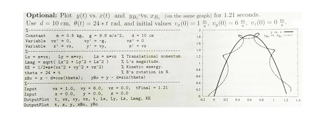

Hello, I'm new to MATHCAD. I was wondering if the following Dynamic Motions problem can be plotted in MATHCAD prime. If so, please show me how! The plot would need to be just like in the picture. Tennis racquet graph.png

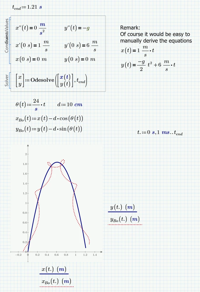

For those simple functions using "odesolve" is kind of overkill and was done for demonstration purposes only 😉

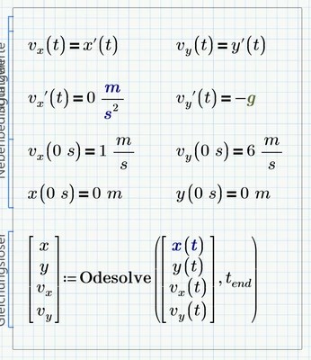

One additional remark: Your pic uses vx and vy for the first derivatives of x and y. This can be done in Prime, too. But in this case you would have to solve not only for x and y but also additionally for vx and vy:
I considered this unnecessary as we could as well define
after the solve block in case vx is needed as a separate function.
