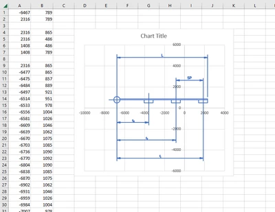

    With the demise of Mathcad 15, I've been sorting through my folders of old worksheets and converting those that need to be carried forward. Among the worksheets, I've found a number of old .mcs image files.  I've come up with a relatively-easy technique that allows them to be viewed.  The .mcs files are simple text files containing rows of 2D coordinates which define line vectors.  Among the coordinates are also some points of "1e307 1e307" which I take to be breaks in the lines.  Here's how I've successfully viewed the file contents:
    1. Import the .mcs file into Excel with the X and Y coordinates in their own columns.  (I use Excel's Text Import Wizard.)
    2. Use the Replace function on the imported data to remove all "1e307" values.  Leave these cells blank.
    3. Select the entire imported data set, and then Insert a Scatter (X,Y) chart into the worksheet. Select the straight-line Scatter type with no Markers.
    4. The chart should now show the vector image.  (See blue in image below.)  Stretch the width/height for size and proper proportions.
    5. If you need to use the image (not just take a quick glance), work with Excel's chart component properties to change colors, remove axes & grid, etc., etc.
