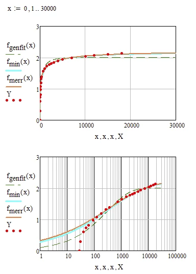

Comparing the three fitting functions it shows (especially in the log-lin plot) that neither provides a good fit for x-values below 100.
For higher values of x, minimize and minerr returned a much better fit compared to genfit.

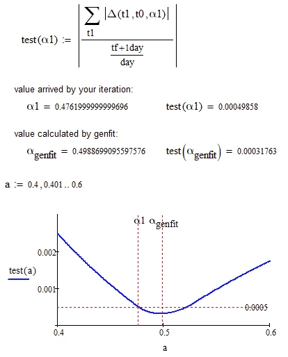

You have to make ajpha1 an additional argument of functions Phi3P and also Delta as otherwise always the same function Phi3P is used, not considering the change in alpha1.
BTW, are you sure that it should read "< 0.0005" in the while condition and not "> 0.005" ?!!
I don't think that you can improve genfits alpha value with your method, which is also very inefficient concerning run time. You should rely on the built-in algorithms an may consider using minimize or a solve block with minerr instead of genfit.
You may test and also plot the cumulated absolute error values

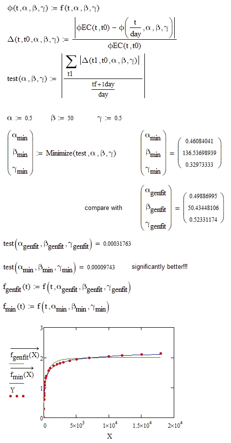

Using this test function you may also use "minimize" to get the best value. It differs a liitle bit from the value derived by genfit and according to the test function its a little bit better.
But this is only a near to optimal value considering that beta and gamma are constant.
Your fit needs you to jiggle around with all three values at the same time, though.
So why not set up the test function dependent on all three and again use minimize:

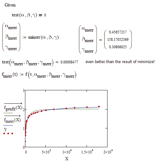

The result is clearly much better than what genfit could come up with.
While we are at it, we can also try a solve block with minimize
The fit now is even (very slightly) better!
