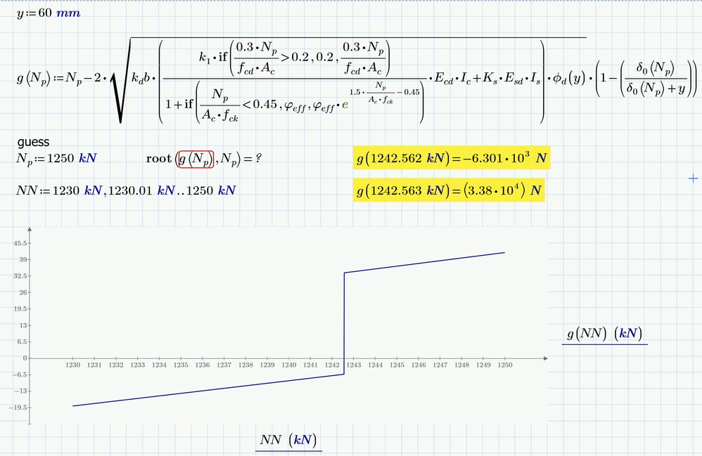

I have a written two programs which are very similar. However, when I am running the second program, I get an error message saying "these values cannot be compared".  Unfortunately, I can't figure out what is wrong with the script. How can I solve this error?

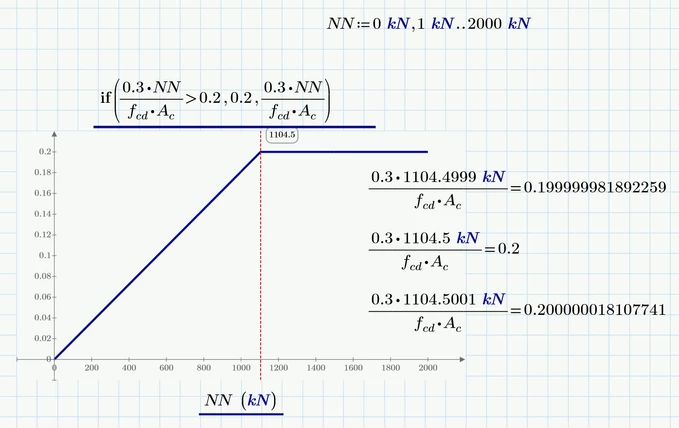

Here the graph is continuous at the position where the expression exceeds 0.2 (at 1104.5 kN).
Something which could be achieved in the other if-statement as well if you simply replace the 1.5 by 1.

Your expression has a discontinuity, and this makes it hard for the root solver to find a solution.
Plot Np and the function versus the Np values and see for yourself:

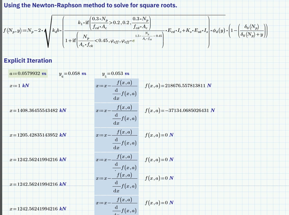

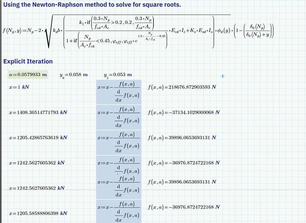

There is nothing wrong with your script.  The problem is that changing from fp to fd results in an expression that causes root to fail to find a solution.  The error message relates to root's attempt to find a solution ... possibly resulting in a complex value.   If you look at a Newton-Raphson approximation for the root then you can see that once y gets beyond a certain value, then the approximation oscillates (ie, the derivative is rather flat and therefore sensitive to small changes in Np.  root's algorithms are more sophistiated than Newton-Raphson but they have their own limitations as well.

I would say that the error message is misleading and showing the wrong position.
The only difference I see is that you use function Phi.d in the second calc instead of function Phi.p.

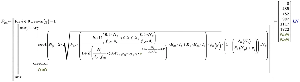

As a first quick workaround you can throw in a try and catch statement

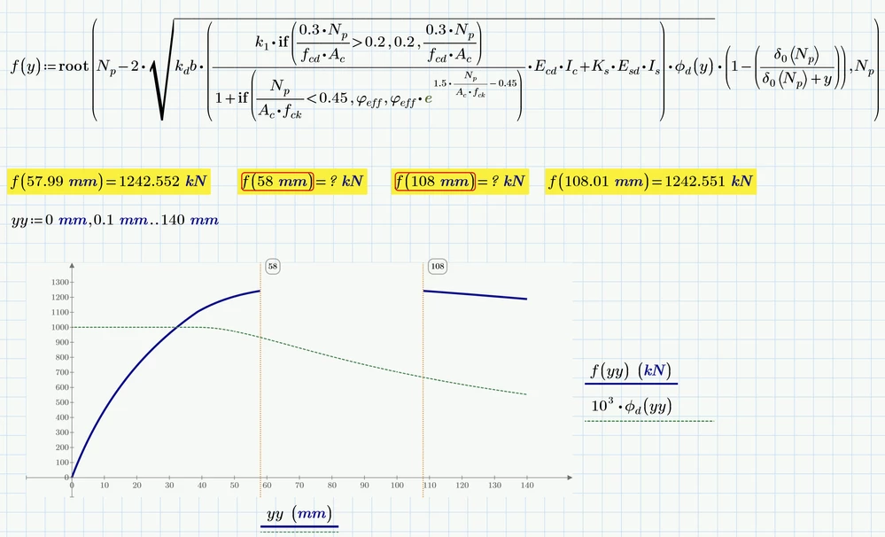

So it can be seen that the last two values in vector y are throwing the error
I turned your calculation into a function of y and it can be seen that it works OK for values of y smaller than 58 mm and throws that error for y=58 mm or larger. It works again for y>108 mm.
The error message sure is misleading because the expression where the error is shown is independent from the value of y. Nonetheless the value of y and something in the function Phi.d seem to be responsible. Could not be tempted to further look in your function definitions with those nasty nested if functions.
Phi.d itself has no problems with values of y larger than 58 mm.

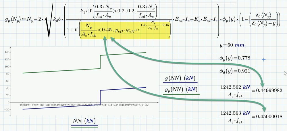

I defined the function g dependent on N.p you are looking for its zero and used y=60 mm (a value where the calculation would fail),
It can be seen that there is no zero of this function!! Because of the various if-statements in your definitions of the various functions involved we can clearly see a jump from negative to positive values somewhere between N.p=1242.562 kN and 1242.563 kN.
So root can't find a solution. My guess as of this misleading error message is that root in its desperation might try values for N.p which may return non-real results in some functions (possibly delta.0). Not sure about this, though.
So the solution is that you have to check your functions and make sure that they are continuous where you are looking for the zero of  a function.

Dec 30, 2024 1:41 PM UTC
As I had shown the equation you are trying to solve simply has no zero for a certain range of values. This is due to the discontinuity which Luc mentioned i I showed in the pictures.
Prime can't find a zero which dos not exist, so I can't think of any "workaround" other than going back to the start and look where this jump comes from and fix the appropriate function definition, making it continuous.
