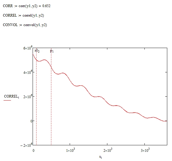

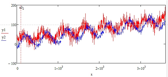

This can be a very simple question for those of you that are expert in signal processing.
Suppose I have two time series y1(i) and y2(i) corresponding to two sensors, affected with noise and measurements errors. Known of course is also x(i), the times of the measurements. It can be assumed that the sampling frequency fs is constant, so that x(i)=(1/fs)*i.
Is there a simple way to estimate mathematically / statistically the time delay (if one exists) between the two measures? For example the "human eye" could see that one signal, if shifted a certain Delta-x, pretty well correlates the other one.
Is it possible, even if the two signals have different numerical magnitudes (say, the second signal is not only delayed but also weaker and maybe with a different constant term)
Somehow I believe this should be possible using the correl(y1,y2) function but some quick tests that I made do not seem to work.

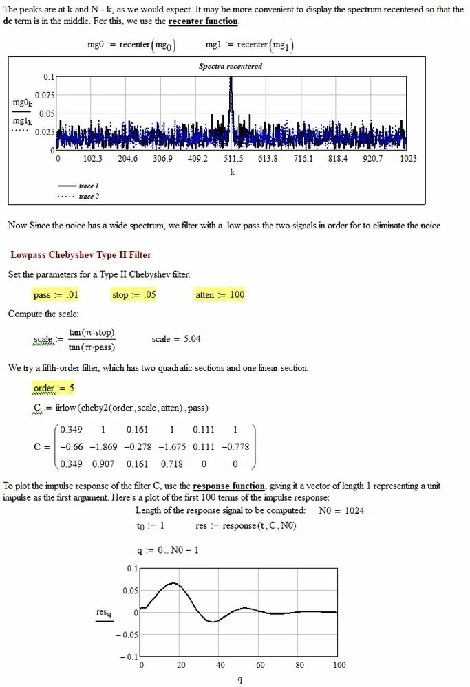

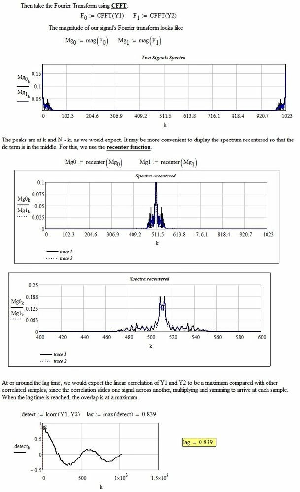

I think that if the signals (for example two random processes) are sampled at the same instants, the sample sequences are also produced simultaneously although with a delay. If viewing the two sequences with an oscilloscope, there is a small delay with respect to each other, it means that either they are placed at different distances from the processor or on the connection line with the processor of one of them, there is a system that makes it delay (a buffer or a logic gate is sufficient to generate a delay of a few nanoseconds). One way of calculating the delay (lag) (thanks to Mathcad E-Book: "Signal Processing") is to use the function lcorr as you can see here below:

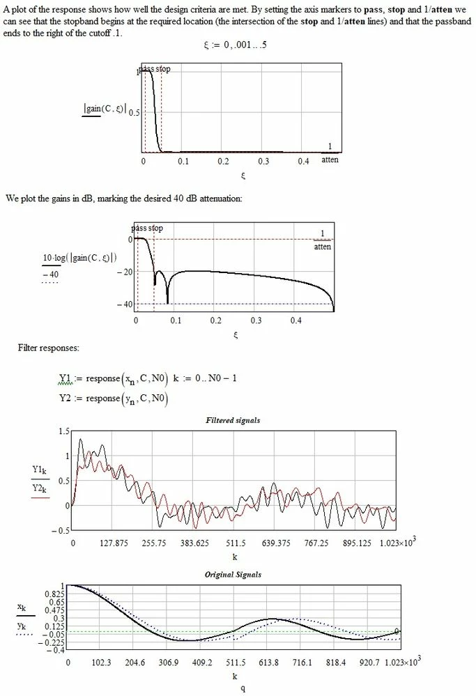

I assume you would want to set a threshold, and when the signal 'reliably' crosses that threshold an event is detected. Then the time difference between events on y1 and y2 would be the delay.
Did you already try smoothing the y/t signals before threshold detection?
Mathcad has several smoothing functions.

Well, I made some detrending and smoothing, but I was hoping in some kind of "wonderfunction" based on correlation plots, that would have a peak in the proximity of the best estimated delay.
The signal has oscillations in it (imagine two sinuses, hopefully with the same frequency added to a constant value and with much noise). And I have many periods available, and it is not a single frequency, it is more a broadband signal. Something similar to this (but this is a test plot, not the real signals, they are more random).
Hope this can explain my question a little better. By the way in this example the delay between the sinuses is x=100, but the correlation function does not show anything special (at least to my untrained eye):

If the signals are periodic, measuring the same wave form from two different locations, then taking the FFT of each signal and comparing the phases might shed some light.

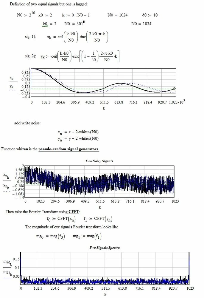

Hi MFra,
and thanks a lot! this is about what I was hoping to be possible with signal processing. By the way, to provide physical background. The signals can be imagined as measures in two different positions of a piping system, where a liquid or a gas flows mit a certain velocity. The delay is of course somehow related to distance/velocity. And the measures could be, e.g., flow-induced vibrations or some other fluid-related measure.
But I have a small question about your example.  Maybe I understand it completely wrong, but it seems to me that your "lag" is delta0, isn't it? the equations defining the signal seem to change the period, not the delay... or else you should put something like (k-k_delay) in the argument of sinc.  Please correct me if I'm wrong.
I will post here my original example, also based on completely invented random numbers. Part of it is in german but I hope it's nevertheless clear enough.

good evening,
(sorry, I don't deny that I wrote my previous worksheet in a somewhat hasty way). However now I have modified the file with your data, and the result is in the attached file. I hope it goes well.
