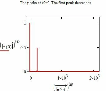

In the attached worksheet, the FFT of a function is calculated. I would like to get the amplitude at each of the frequencies from the signal. From the plots of the FFT magnitude at various frequencies, it can be seen that the peaks amplitude decrease with increasing the frequency. The plots also show that sometimes the first peak is larger than the second peak and sometimes it is reversed.
I was wondering if this is a natural behavior of FFT or I must modify the script. I greatly appreciate your advice.

1. The cases of z= 5 and z=500 show the same symptom: leakage. Due to the spacing of the sampling intervals, integer z does not correspond to integer # of cycles over the full sampling period.I added some functions in rev2 (attached) to calc power and actual bin number. z=5 is centered at bin 4.69, z=500 is centered at bin 469.19. the different fractional spacing explains the difference in spectral component amplitudes - leakage is spread differently.
2. When z=0.1 (low) , the actual value of the sampled function is near 0, not 1, since the sampling does not start at zero argument of the cosine, since k has an initial offset. Not sure why this is need, since the spectrum depends only on the span of the sampled data, not the origin. In any case, the waveform for z = 0.1 is around the zero crossing of the cosine, not near its peak.
3. When z =0, the sampled function is constant=1, giving only a bin(0) value = 1, the average (only thing present). When z is not zero, the cosine consists of two complex exponential components, each of amplitude 1/2, one at bin# = z and one at bin# = -z, which shows up at bin# = N-z since the spectrum is effectively periodic with N, the # of samples.moving from z=0 to z not 0 results in switching from one component with value 1 to two components of value 1/2 each. The FFT returns only one of these. You have to reconstruct the other.

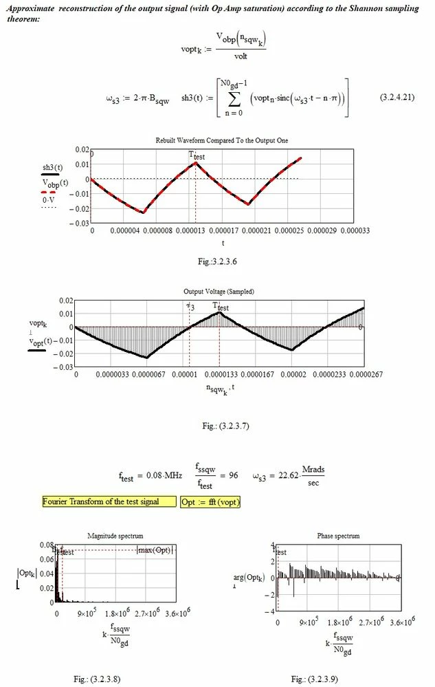

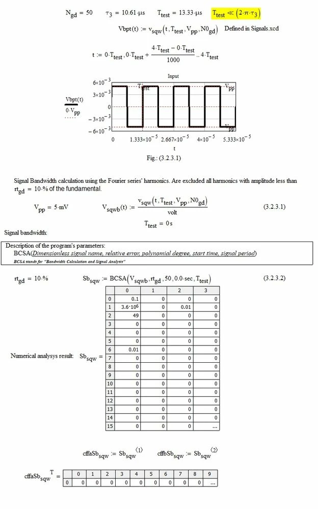

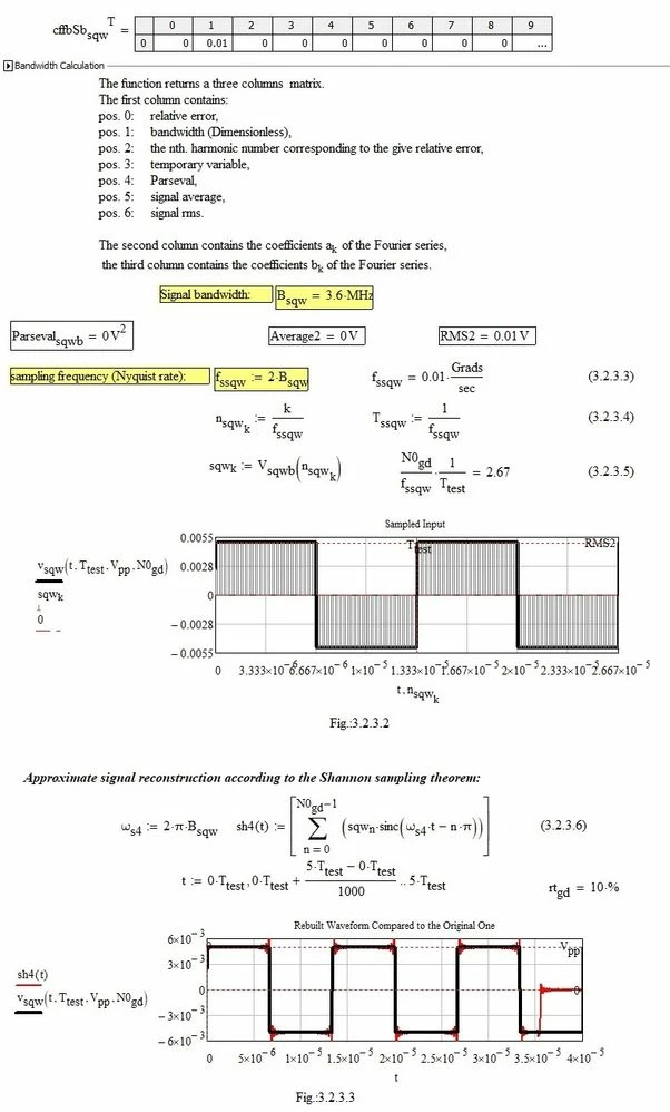

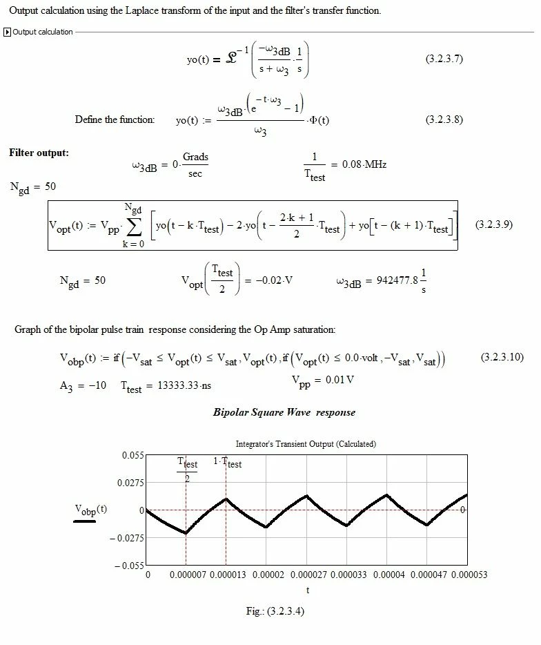

FFT must be supplied with a vector consisting of, for example, samples of a continuous function. The function must be sampled respecting the sampling theorem, that is, you need to know the sampling frequency. In your case the FFT argument is a function which in turn has only an independent variable z0 as its argument. In the function, however, the k that varies with q is also present. It does not seem to me that FFT receives an array of samples, but does what it can and returns what it can. An example of how you should proceed is the following:

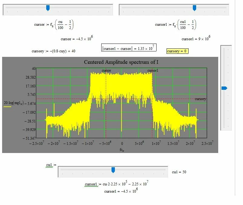

Then, to know the amplitudes of the harmonics you can use the sliders as in the following figure relating to an IQ-QPSK signal:
