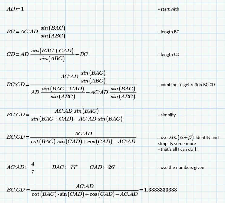

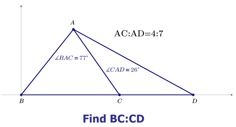

A memory from school days :-):
Since only the aspect ratio is sought, the choice of the line lengths denoted by the ratio 4/7 is irrelevant – this is a problem of so-called similarity geometry. In all situations similar to the given geometric structure, the same ratio results in the solution. Therefore, with the help of a calculator, paper, and pen, choose AC and AD in the assumed ratio ---> BC/CD = 1.333...
Perhaps there is a clever solution using reflection/symmetry that doesn't require any calculations. I'll have to puzzle it out.

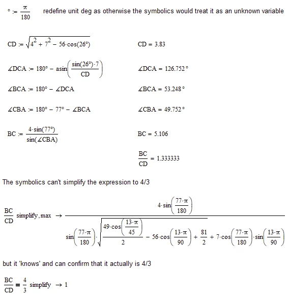

Apr 27, 2025 10:38 AM UTC
I can confirm your result, but unfortunately Mathcads symbolics is not able to simplify it to 4/3 which probably is the exact result.
And I am pretty sure that @ttokoro  will provide a very basic and clever geometric solution without much/any calculations 😉
Her my brute force attack in MC15

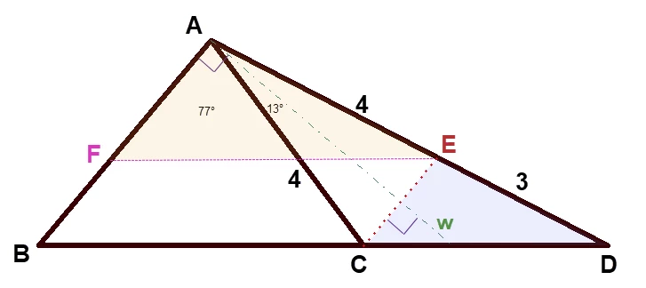

Apr 27, 2025 12:09 PM UTC
Let's consider the angle symmetry w of angle CAD.
Because 77° + 13° = 90°, it is at right angles to AB.
Now, if we reflect point C across w, we get point E on the line segment DA.
CE is therefore parallel to AB (both are perpendicular to w).
Now draw a parallel to BC through point E and intersect it with BA at point F.
If we choose AC=4 and AD=7, then AE=4 and ED=3.
The triangles CDE and FEA are similar triangles, so because FE=BC, we get the ratio
FE:CD = BC:CD=AE:ED=4:3

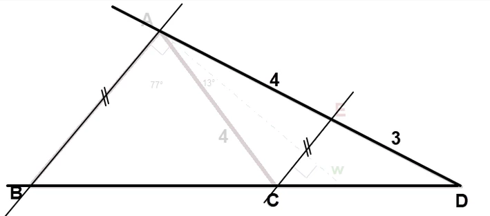

Apr 27, 2025 2:12 PM UTC
Ooops, OK, a much easier and more straightforward way is using the intercept theorem.
Lets construct point E as described above which intersects the line AD at the ratio 4:3.
Because AB and CE are parallel it follows immediately that BC:CD = 4:3

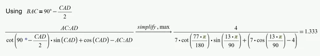

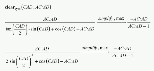

Apr 28, 2025 4:16 PM UTC

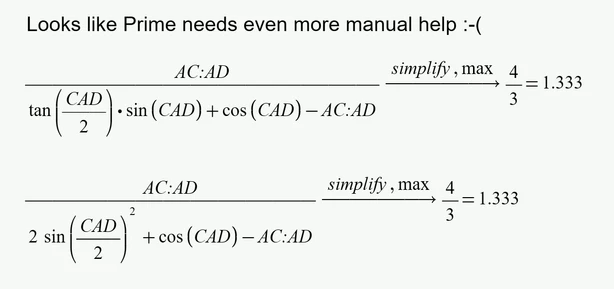

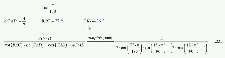

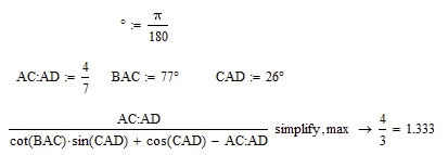

Looks like old Mathcad 15 with muPad is a bit more capable here
Prime 10.0.1.0:
Maybe  applying the special relationship between the two angles can help ...
Disappointment!
So lets manually apply some double/half angle rules
Heureka! Now even Prime is able to finish the job!
It even works symbolically without assigning values for CAD and AC:AD
So it seems that Prime's Symbolic doesn't know all that much, but it obviously at least knows the relationship
and therefore can simplify
Nonetheless its much simpler and straightforward in real Mathcad
But one should not give up hope - perhaps one day Prime will also grow up and be more or less on a par with good old Mathcad. After all it's been less than 20 years since Prime 'replaced' Mathcad as the successor. 😉

Thanks all how to solve this puzzle by Mathcad.

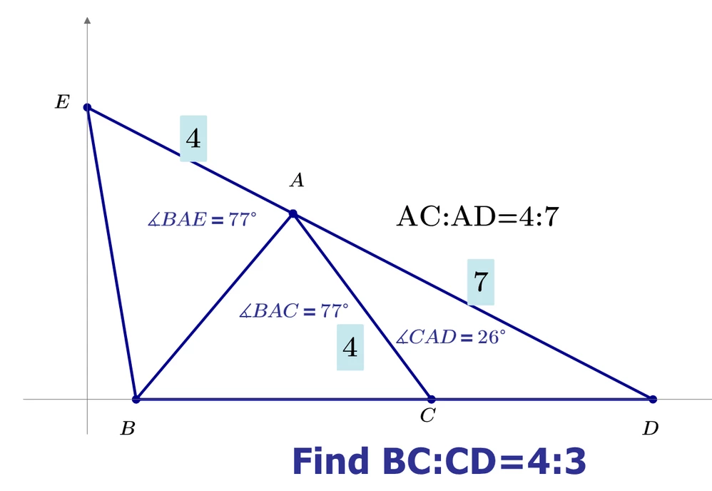

Apr 30, 2025 1:53 PM UTC
I see that D, A and E are collinear and that BC=BE. Basically ABC is mirrored at AB.
But I can't see the answer BC:CD=4:3 in your picture ....???
Of course, it's quite possible that I'm simply blind and can't see the wood for the trees.... 😞
ttokoro
ttokoro21-Topaz IAuthor
Apr 30, 2025 10:59 PM UTC
D, A and E are collinear so the area of Triangle BED is divided by S(B,D,A):S(B,A,E)=7:4.
ABC is mirrored at AB to ABE. So, S(A,B,C) is also 4. Therefore, S(A,C,D) is 7-4=3.
B, C and D are collinear so the area of Triangle ABD is divided by S(A,B,C):S(A,C,D)=4:3. Therefore, BC:CD=4:3.
Using both area and line length rasio of triangle with same hight is the tips.
Tokoro.
