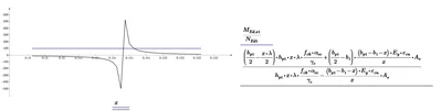

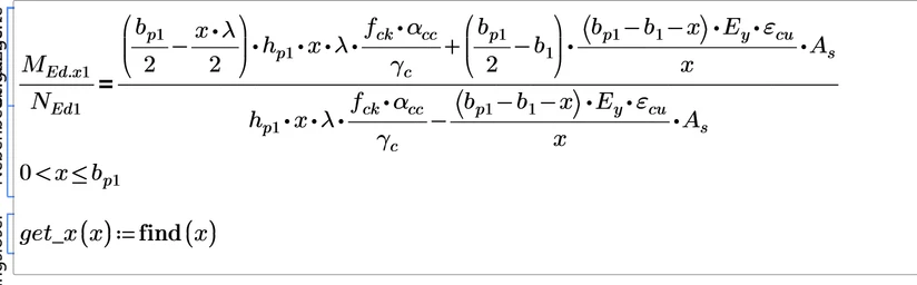

I'm trying to find solution with solve block, but possibility to find result depends on "x" (would like to find) initial value. How to determine proper "x" initial value? I would like to use Mathcad for automation, but if it's not clear what initial value I must use, it will not be possible. Thank you!

I've plotted the left and right side of the equation you're trying to solve:

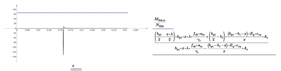

There are two points 'where the two shall meet', but you have to zoom in to find them:
Here is one of them:
It's the 'return from above', the other one is hard(er) to find.

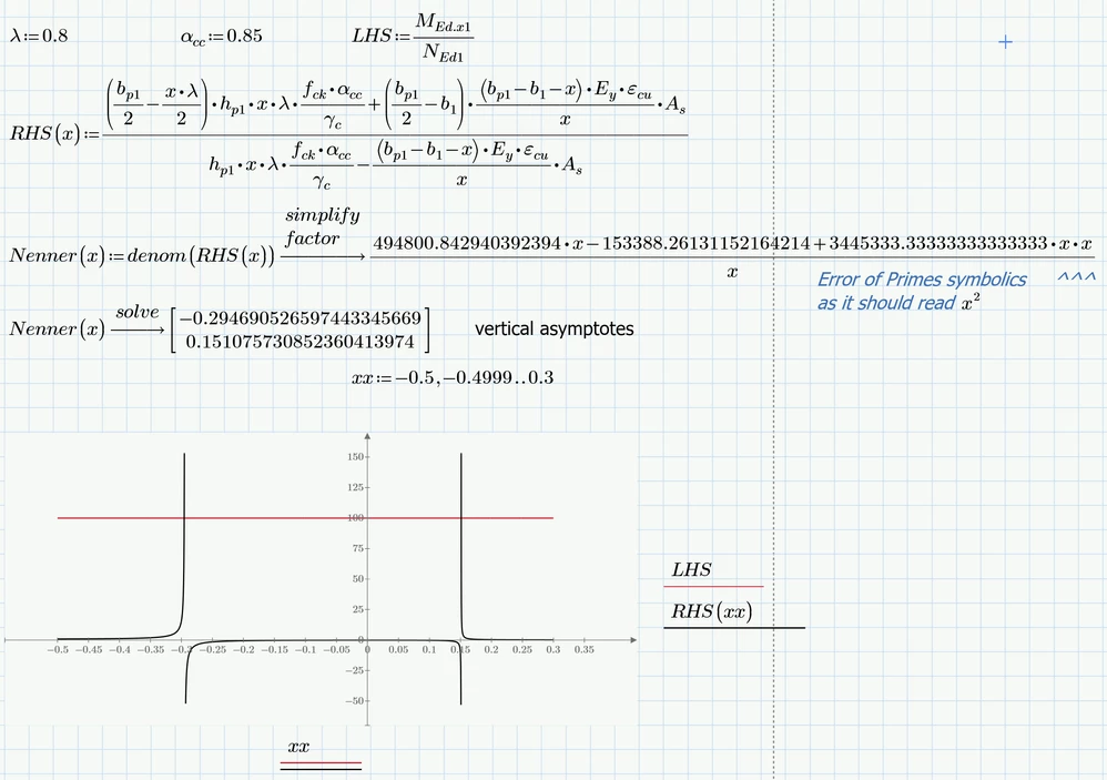

Actually there are two negative solutions - one at -0.296 and the other at -249.4.
We have two vertical asymptotes and the two solutions are at the left of the leftmost and to the right of the rightmost asymptote.

You demand your solution to be in the interval from 0 to b.p1=0.36. So why a guess of x=1. Actually even higher guess values work OK, but I would rather use b.p1/2, a value sure within the interval the solution is supposed to be.

So its up to you to make a good guess, probably based on a plot like the one above.
Looking at this plot it seems that it may better to chose  a guess to the right of the asymptote (greater than 0.151).

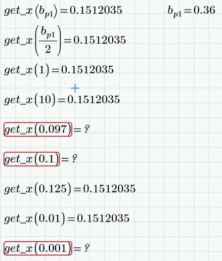

You may also parametrise the solve block, turning it into a function with the guess value as its argument.
That way you can easily test various guesses:
As you can see its hard to tell why a guess let the solve block fail. In your case higher guess values seem to be no problem.
Guess values in the range from the vertical asymptote up to 1 (and higher) seem to work all the time.

But again, looking at the plot it seems not to be wise to use a guess value to the left of the rightmost vertical asymptote.

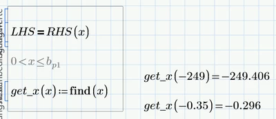

If we disable the additional constraint we also can get the two negative solutions
