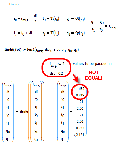

Given/Find in function definition doesn't work right - parameters passed in ignored
I'm trying to define a function with a Given/Find solve block inside. i.e. the function calls a Given/Find block.
I found this thread on how to do it
Embedding Solve block in a function - PTC Community
It had an example file:
https://www.ptcusercommunity.com/servlet/JiveServlet/download/30310-2824/collab%20-%20solve%20block%20demo%2001.mcd
The problem I run into is that the values I pass into the function (which is used by the Find block), is ignored. Well, not exactly ignored - I think it uses it like a guess value. It solves the system of equations, but the parameters I passed in are changed.
My file is attached.
TIA,
Jason

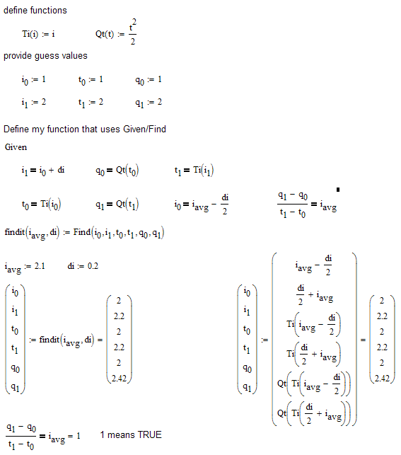

First off:
You cannot use an assignment (shows as :=  ) inside a Solve block. In a Solve block you describe constraints, you must use boolean equals (normall a bold =  ).
23-Emerald V
Then the result of the Solve block should contain all variables you want to solve for:
So after a small rebuild:
All constraints are satisfied.
JasonC1-VisitorAuthor
There's something not right
This statement
     i0 = iavg - di / 2
is NOT a constraint. It is merely an initial value for the solver. That's why I used := instead of = (bold)
The correct answer is at the bottom of the sheet.  The correct answer for i0 is NOT equal to iavg - di/s

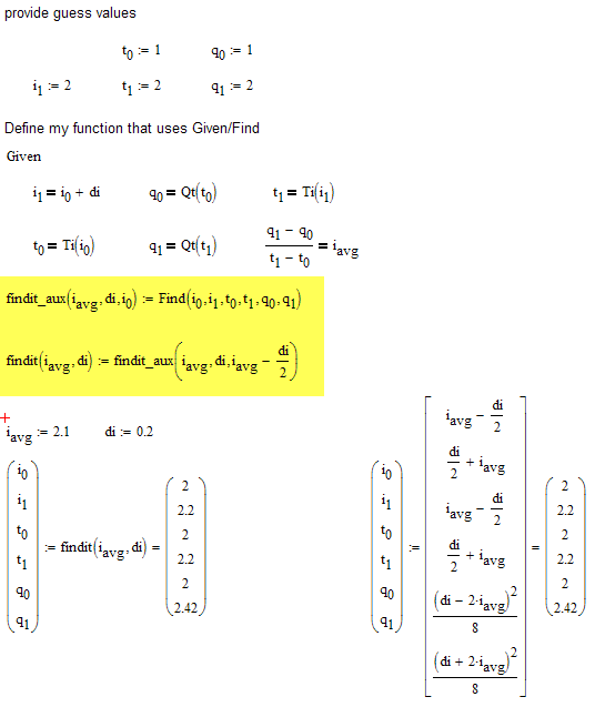

If you don't want "i.avg" and "di" to change, you should not solve for them. Just solve for the other 6 variables.
You have 6 variables to solve for, but seven equations. It looks like
is redundant (at least with the equations Ti() and Qt() you provide) and can be omitted. You had done this yourself in your last solve block where you said that the results would be correct. (For some reason you also had changed i.avg from 2.1 to 2 there). EDIT: Just noticed that you had not omitted that equations but that it was hidden underneath the Find region. Nevertheless the equation is redundant, other Mathcad would refuse to find a solution.
As your system is quite simple, you may also consider to solve it symbolically and use the resulting expression which are depending on i.avg, di and the two functions Ti, Qi, to calculate the variables you are looking for.
You would have to go for a symbolic solution before you define your functions and the guess values. Heres the numeric solve block:
Just read your answer to Luc and that you want the guess value for i.0 to be dependent on the arguments i.avg and di.
This is a little bit tricky and can be done, by turning the solve block into an auxiliary function with three arguments and defining the real function findit to call it with the appropriate guess value:
