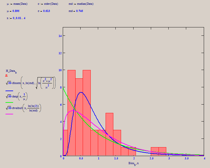

How about this:
I find the best correlation for a lognormal distribution, but one might argue that Weibull fits better.

but how did you graph the dweibull(x,s) although we did not know the value of s ?
23-Emerald V
Jul 8, 2015 3:38 AM UTC
Mohamed Ali wrote:
Thanks for reply
I just guessed from the look of the curve and chose 2 (or, rather, left it at the value I'd used to generate the dummy test data earlier on in the worksheet).   The genfit function should then have improved upon that value.

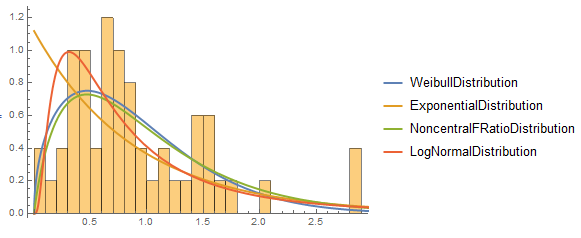

Jul 8, 2015 6:57 AM UTC
These are just my thoughts.I have a Mathcad 15 but does not work on Windows 8.1.I tried this in the Mathematica software. There is such a function called "DistributionFitTest"  calculates the "p" probability and tested whether data is distributed. A small p-value suggests that it is unlikely that the data came from dist.
  • WeibullDistribution p = 0.422665.
  • ExponentialDistribution p = 0.00122985.
  • LogNormalDistribution p = 0.0165806.
  • NoncentralFRatioDistribution p = 0.676676.
So "NoncentralFRatioDistribution" fits is  best.Of course, I'not checked all distributions , it may be better fit there are so many.
