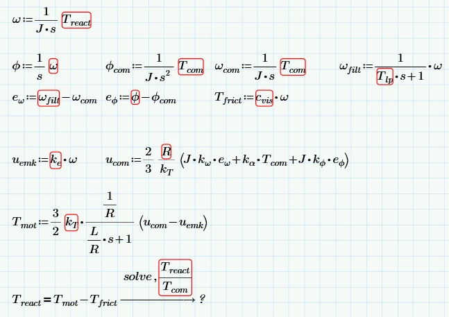

I want to solve the following equation at the bottom and get T_react/T_com on one side and the rest on the other side. Is there a way to rearrange the equation like that?
I am using Version 10.0.1.0

Solve for the two variables (make sure you have two independent equations then), or define a single variable e.g. Tratio, and solve for that.

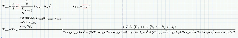

Note that the solve you display doesn't work because Treact and Tcom are not part of the equation Tmot-Tfrict.
If you want to use something like this, you have to define Tmot and Tfrict as functions of Treact and Tcom (and that ripples through to the beginning of your definitions.

I tried implementing your solution, but I don't fully understand what you mean. I used Tratio as a variable for Tmot and Tfrict and tried to solve Tmot-Tfrict for Tratio, which isn't working,

You defined Tmot(Tratio) , but Tratio does not appear to the right of the definition symbol, so it is actually not a function of Tratio.
You have more work to do. I think you would be better off with two equations, like this:
Note that I would rather do this like:
But I cannot decide what the right equations would be for your problem.

How about
Prime 10 sheet attached
Jan 9, 2025 12:38 PM UTC
Thanks alot, that is exactly what I wanted!
