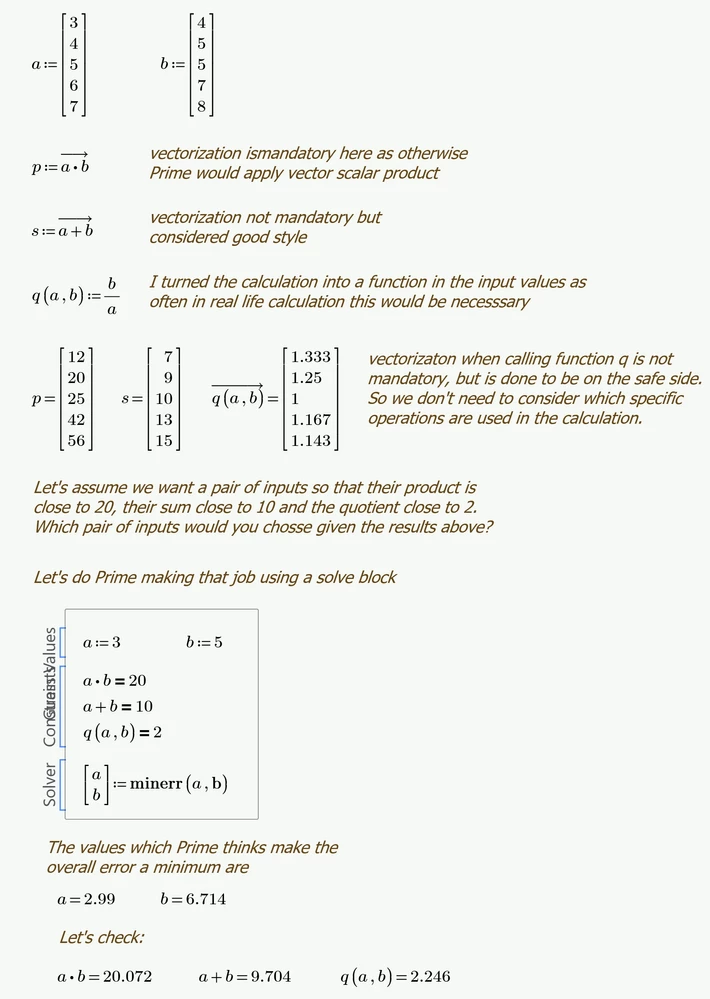

But .... you actually ar not interested in 100 results returned for 100 input combinations. You ar just interested ind the one combination which comes closest to a specific goal, right?
This might(?) be a job for a solve block, maybe using 'minerr'.
Here a simple example of what i am talking about:
You could also add additional constraints or 'weight' a constraint if its important that it is fulfilled (see attached sheet).
All constraints in a solve block are 'soft' constraints, though.

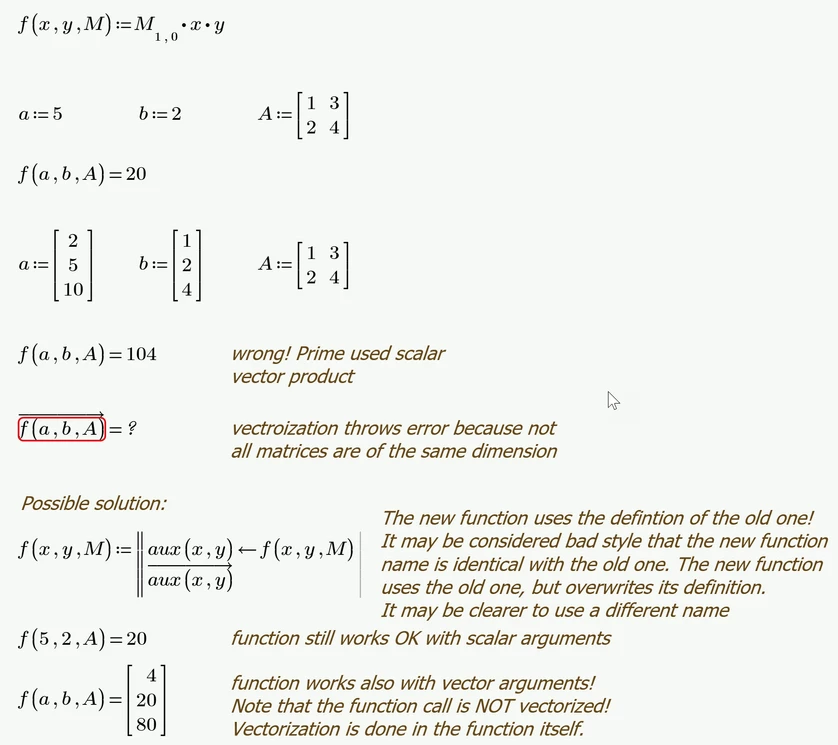

The calculations themselves using vectors and matrices is one of the cases which I called 'pitfalls' in my answer above. It possibly could be solved using additional auxiliary functions. How exactly would have to be examined on a individual and specific situation.
Here again a simple example - the product of the two inputs should be multiplied with the lower left element of a provided 2x2 matrix. A function should do this and use both inputs as well as the matrix as its arguments:
