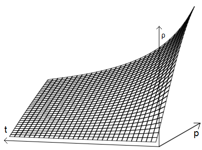

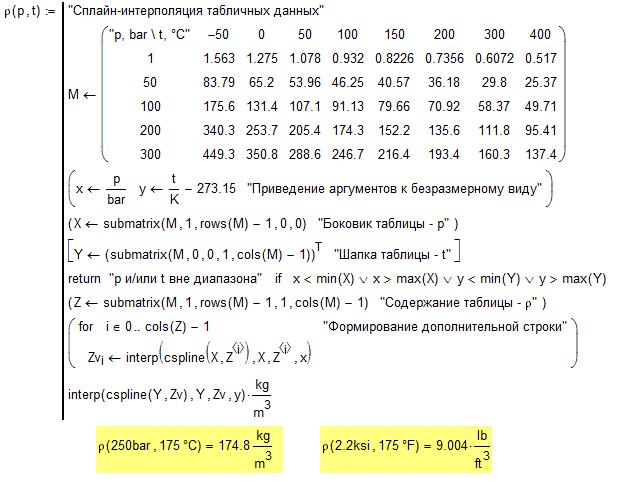

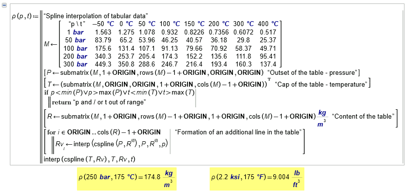

One way to do it: M[i, j -> f(x, y) -> Surface
or Mathcad Prime
and the plot
