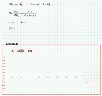

I am trying to get a bode plot of a transfer function which I symbolically evaluated first. After that I want to insert some constants and then use it for a bode plot. Is there a way to do that?
I am using PTC Mathcad Prime 10,0.1.0.

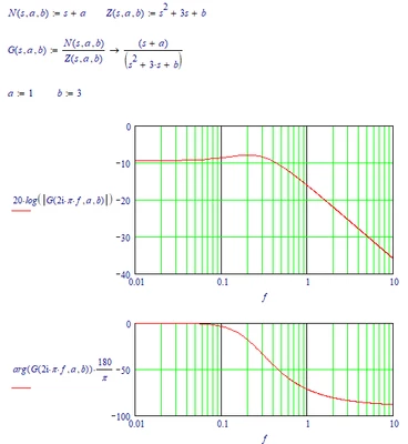

There's no problem, in fact it is advisable, to do what you want. You just have to carry the unknowns as parameters in your functions. See here:

To start, move the definitions for "a" and "b" before your equations where you use those variables.  Mathcad doesn't know what they are when the equations are executed.  Once you do that, you might find that things are easier to troubleshoot.

The thing is I want to see the symbolic evaluation at first, since this version I've showed in my file is just a simple example. The evaluation I do a is much more unclear than in the example, which is why I need to see it first. Or is it not possible to do it this way in Mathcad?

You can't do it that way, because Mathcad evaluates your equations line by line from top to bottom and left to right.  So, you're trying to evaluate a function that has variables which are undefined.  The other issue is that your functions don't evaluate to a result.  See the WS3 attached.  N(s) and Z(s) don't mean anything because "s" is not defined.  It could be a function or a variable.  Mathcad doesn't know how to interpret that.
I created new functions N(t) and Z(t), where "t" is defined as mathematic operations of "a" and "b".  Those functions evaluate to a result, and so does "g", So you have to define or evaluate every term in your equation.  You also used the solve function to evaluate the result of G.  You can do that, but you have to define it differently, i.e. you have to state what variable you're solving for.  Since "s" is unknown in both equations, G(s) can't be evaluated.

LucMeekes23-Emerald VAnswer
23-Emerald V
Jan 23, 2025 6:27 PM UTC

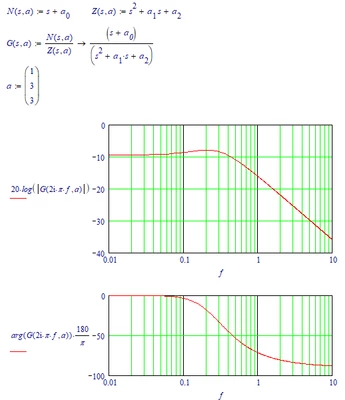

And if you think you have to carry too many parameters into a function, you can put them in an array:

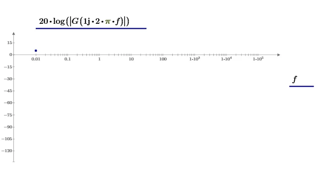

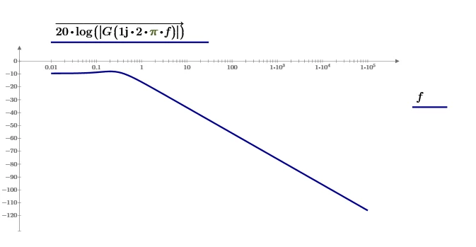

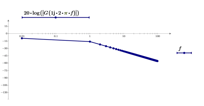

Prime 10.0.1  If useing logspace function, plot needs vectorization, however, linear range doesn't need.
