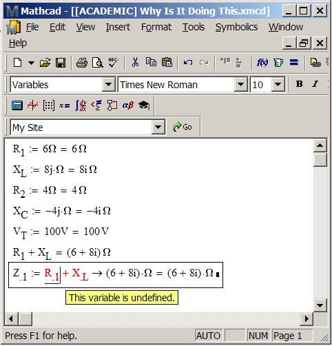

I spent an entire week out of my life neglecting my responsibilities while probing the mathcad help menus and tutorials and quicksheets so I could figure out what I'm doing wrong. I'm not doing anything wrong. I've included my latest worksheet as proof. I can't believe mathcad does not have an option for updates in the help menu like every other reputable software company on the planet. Am I going to have to search for some kind of update file on the ptc website to fix the bugs that come with the Mathcad 15 software that I paid for? I sincerely hope I will not have to purchase a yearly maintenance plan so that I can get basic bug fixes for "The Global Standard for Engineering Calculations."

It's not broke; and it's not wrong.
The red and error are symptoms of your call to the symbolic processor. But the evaluation of Z_1 iss correct.
If you type Z_1:=R_1+L_1 and enter there will be no red, and Z_1--.>will get you the proper answer.
Red errors and symbolic processes are not new.

It is not a bug. When you use the explicit keyword you are asking the symbolic processor to replace the variable with it's numeric value. In this case, it can't, because the symbolic processor sees ohms as an undefined variable. The symbolic processor does not know about units. That is a limitation, but it''s not a bug. Since PTC (or previously Mathsoft) did not write the symbolic engine there is little they can do about that.
February 15, 2011
Why are you doing a symbolic evaluation followed by a numeric evaluation (if you are not aware of the distinction please say so, and you will get the 5 minute introduction)? The symbolic processor does not know about units, and that is the source of your problem. If you do a symbolic evaluation you see the symbol for Ohms, but it's not the unit of resistance, it's just an undefined variable. The symbolic processor does not care about undefined variables (after all, it does symbolic math!) but the result from the symbolic prrocessor is then passed to the numeric processor, which does care about undefined variables. If you want a numeric evaluation, use the numeric evaluation operator. If you want a symbolic evaluation use the symbolic evaluation operator, but always be aware that the symbolic processor does not know about units.

I've gone through the posted worksheets, and Richard's example clearly shows the bug. I've logged the bug for both Mathcad 15 and the issue for the new version of the software, Mathcad Prime 1.0, as we implement symbolics in it.
As Richard pointed out, symbolics and explicit don't currently handle units, so you see some issues. He provided some workarounds for you.
We prioritize bugs for each release. It may seem easy to you to fix this issue, but units aren't implemented in symbolics, which makes it more complex.
If you recently purchased Mathcad 15, you also received a license for Mathcad Prime 1.0. We will be adding symbolics to Mathcad Prime.
Mathcad Prime 1.0 has both dynamic units, and units added to most functions, plots, and tables. It also allows mixed units in matrices, which is not a feature of previous versions of Mathcad. As we add symbolics to Mathcad Prime, we'll be adding improvements to it as well.
I hope this helps answer your questions.
