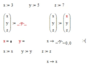

September 5, 2019
To reset a variable symbolically AND numerically you may use the two step procedure shown in the picture.
But it sure is cumbersome and failure-prone to do so with all variables one by one.
The variable name "_-y-_" simply was chosen to ensure(?) its a name still undefined and unused.
Numerical clearing could be done using a vector, but symbolical clearing must be done singly one by one:
September 5, 2019
And the order in which you 'undefine' does matter.
First do the numeric, then the symbolic.
If you reverse that, your variable will be symbolically defined to whatever you chose as undefined symbol.

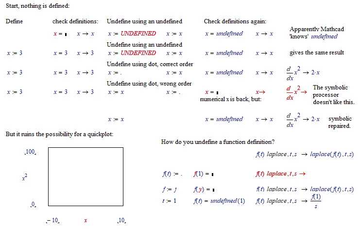

September 5, 2019
Hmm, nice find, but it's not quite the same I fear.
(I wonder if Mathcad 15 is the same.)
September 5, 2019
Here is a pdf-print of your sheet from Mathcad 15.
As you can see MC15 acts differently than your MC11 in some cases.

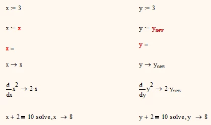

11-Garnet
September 6, 2019
Thanks again to all, Luc and Werner_E in particular.
Still naive here:
Let say I have x :=3, by using:
x:=x.   (the final dot comes hidden, since it is captured in MC11 as a way to put a text subscript, if I am correct)  gives
x =     (in red, i.e. empty), and symbolically it gives correctly
x --> x     and  solves dx^2/dx --> 2x
 The hidden dot is still there in the symbolic calculations, but can be put completely invisible just by typing a space after it x:=x.[space]. It works also in  case there is already  a text subscript, like xy - just add "." after y.
PS: @Werner_E  in MC 11 after using x :=.  I don't have x=0 as you are showing in MC15,  but x= (in red, i.e. undefined).
September 6, 2019
It does not matter if you assign x:=x. or if you use x:=x.new or any other variable name which was not used in the sheet.
As already written above this clear effectively the variable for numeric use, but when it comes to symbolics it does not the very same as x:=x is doing. Nevertheless it might suffice for some needs.
Thats not correct! You get x --> x. and dx^2/dx --> 2x.
Note the dot after x. It looks like x, but it isn't. I can image that this is OK in a lot of occasions, but maybe not in all.
11-Garnet
September 6, 2019
I noticed that, thanks, and I was editing my last post, while you were posting yours.
You are correct: not exactly a pure "x"! But for most practical purposes it could work.
