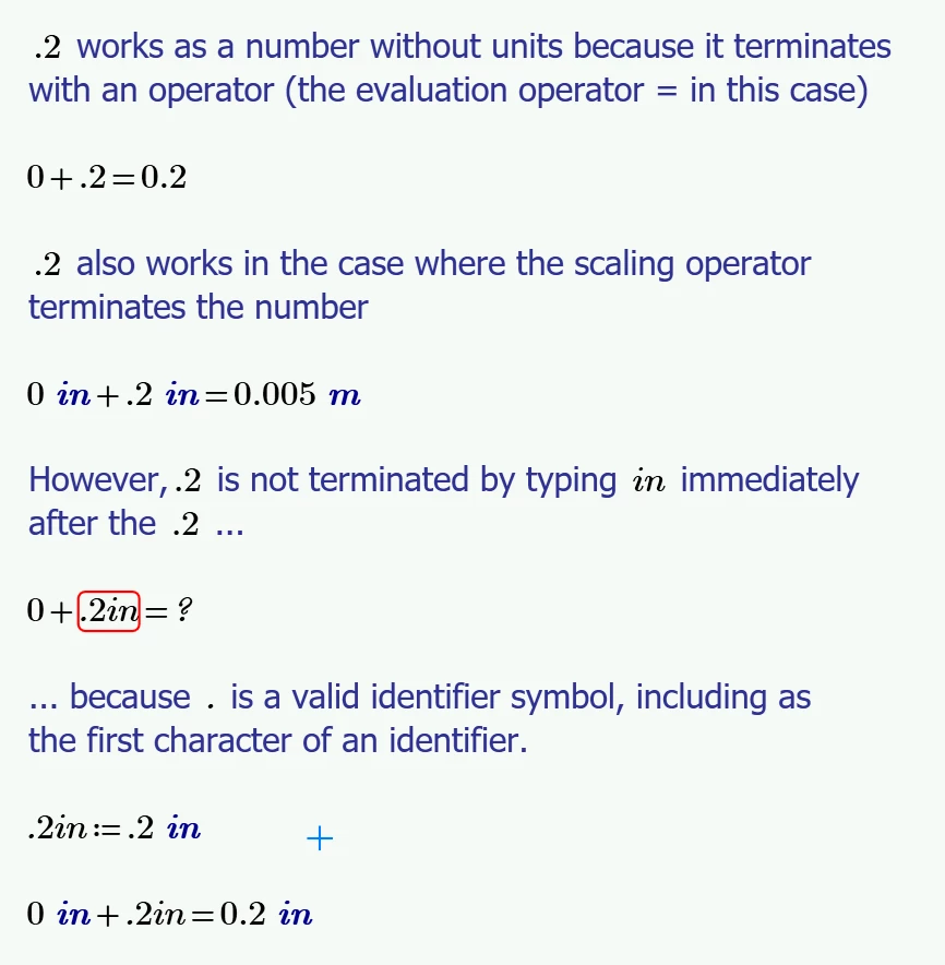

MathCAD Prime 7.0 is where my company is still stuck at, but it still has the very frustrating limitation/bug of not accepting decimal numbers without putting a leading zero before the decimal. It allows you to do this when calculating a number, but not when using units. Has this been fixed in subsequent versions?
It is frustrating not only from the standpoint that I never put leading zeros before a decimal, and never have, never do on any other program/software, and it's not a problem at any other time on any other software package I use (including MathCAD Prime 7.0) UNTIL I try to use units in the calculation. I have hundreds of worksheets where I have not used leading zeros and it used to calculate everything just fine, even with the use of units.

The reason you can't type ".2in" is because the dot is a valid leading character in an identifier name.
When the number begins with 0, Mathcad Prime recognises a non-numerical character as the number string terminator (unless that character is an i or a j, in which case Mathcad interprets the number as imaginary).
Stuart

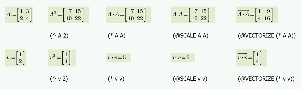

I've occasionally wondered why PTC called it the "scaling operator" or, to be more precise, why they gave it the functionality they did.
AFAICT, the "S-expression" associated with each maths region doesn't so much affect the nature of the calculation but rather the chosen display form.   Certainly, the scaling operator scales scalars, but its prime(!) purpose seems to be to tell Mathcad not to draw a multiplication operator between terms that Mathcad is actually multiplying.
The Hadamard (element-by-element or vectorized) product would, IMO, have been a more mnemonic operation on arrays.
