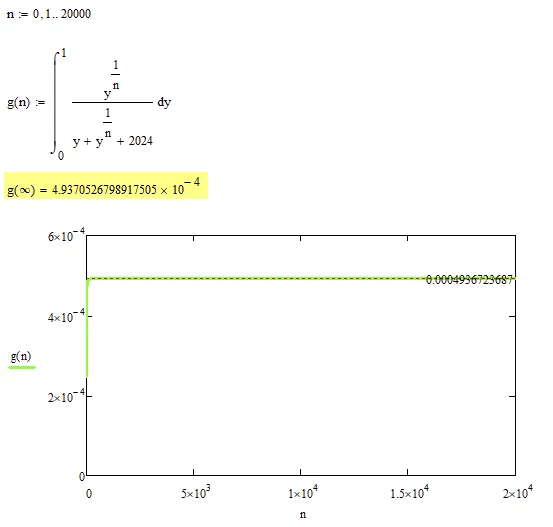

Feb 14, 2025 5:17 PM UTC
The equivalent function g(n), which is obtained by substituting y=x^n, is numerically much more stable!
Nonetheless, Symbolics is still unable to find an exact symbolic solution when applying the limit
However, it is possible to do it this way
which of course is equivalent to
a basic integral for which we would not need any software 😉

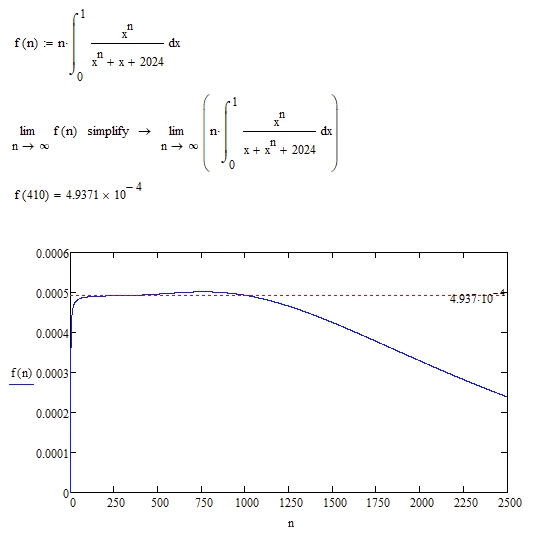

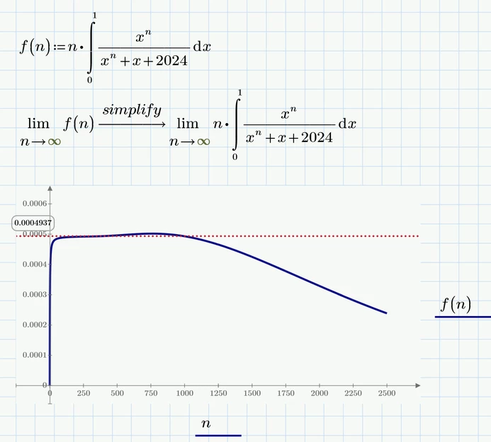

Feb 14, 2025 1:58 PM UTC

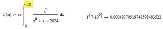

I don't think that Mathcad or Prime are able to arrive at a solution.
The symbolics of both is not able to come up with a solution and the numerics runs into severe round-off errors for higher values of n.
Here the "results" of Mathcad 15 and Prime 10:

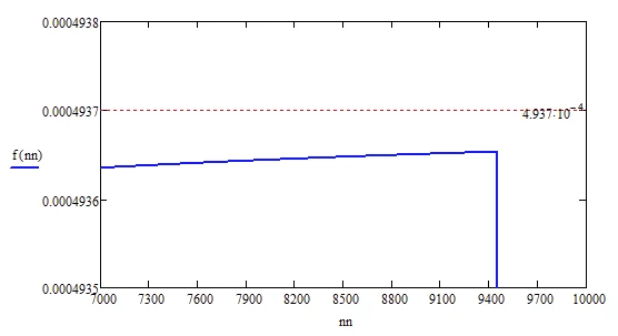

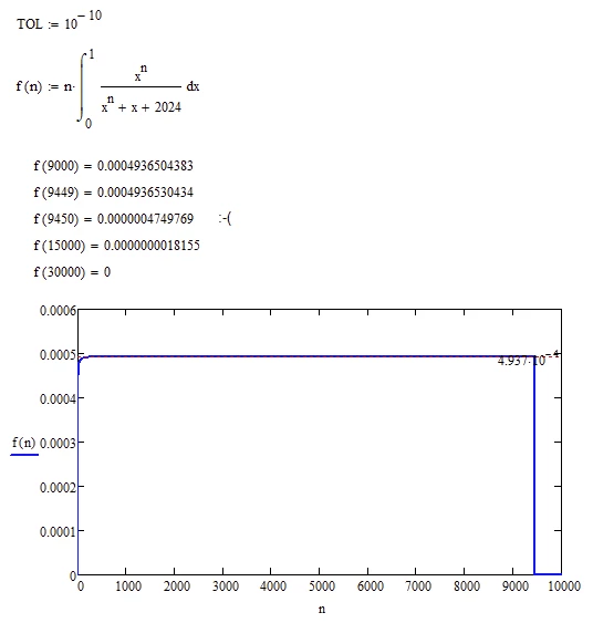

Feb 14, 2025 2:23 PM UTC
Additional remark:
We can improve numerical accuracy significantly by decreasing the value of TOL.
But there will always be a value for n above which numerical inaccuracies will strike and falsely pull the result towards zero.
In case of TOL=10^-10 its the values above n=9449 which yield inaccurate/wrong results.
We can zoom in to see the results approaching the value you named and then the sudden death of the numerics starting with a specific n-value
If you force the symbolics into numeric float mode by using a decimal like 1.0 instead of just 1, we can get a pretty good approxumation
I had no luck with much larger arguments, though ('endless' calculation).

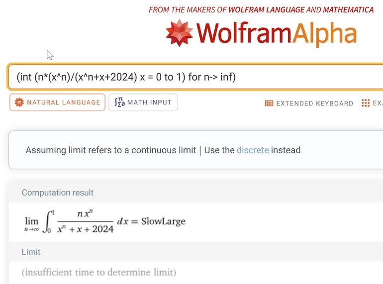

Also tried Wolfram Alpha, but uncle Wolfram wants us to insert coins to buy more computation time ...

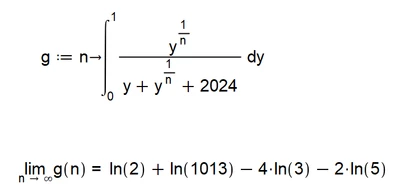

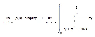

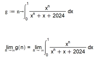

Feb 17, 2025 8:56 PM UTC
This is what I got in Maple Fl;ow:
Feb 17, 2025 10:57 PM UTC
Great!
Can Maple Flow also handle the original expression (in x) before doing the substitution x^n = y ?
Feb 18, 2025 10:47 AM UTC
Looks like it can't
