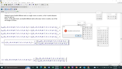

I'm trying to solve, in general, one equation that is important to me.
The idea is to find through my Mathcad Prime 9.0.0 the extremum value of a parameter in symbolic representation.
Here, I faced some "wall barrier" for solving due to the famous discouraging phrase as
"The symbolic result returned is too large to display"...
What was previously done:
1. The simplification of each step of the calculation formula was performed, but the final point was to calculate the Zee matrix...
Mathcad didn't want to represent the particular calculus step, and I was deeply stuck, with no idea how to solve my issue.
My objective in this step is to solve the derivative equation when I set the k1 value (Internal area heat capacity) equal to zero by only two variables (width of the layers d1 and d2, respectively)  to find by such derivative equation to obtain a maximum of k1 value in the general case depending on two variables (width of the first layer d1 and d2 respectively).
The attachment has two files (MathCAD Prime 9.0.0)  that probably could shed light on the problem - the work solution for particular initial data and the symbolic unsolved.
I would appreciate any information regarding the math and help you can give.

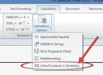

It may help to omit the units when using symbolic calculations.
If you use units with symbolic calculations, it may help to turn on this option and let the sheet recalculate:
I also noticed that in your definition of matrix Z none of the units are labelled as being a unit (bold blue). This may make the symbolics think that  variable W and unit W are two different variables, which sure can blow up the result.

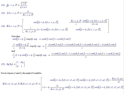

I would approach it symbolically this way:
and further...

if I understand your point, did you simplify each matrix component and represent delta and dzetta values as functions from variables?
Whether the function has no extremum point(can't find the solution at first derivative =0),
or Machcad can't cope with the calculus of symbolic equations, as @Werner_E   noticed...

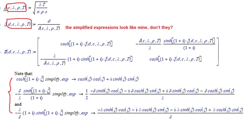

I looked up the original expressions for the heat transfer in the referenced source document to find a more compact description of the matrix Z, because I did not want to type those large expressions.
The simplify,exp statements actually rewrite the simplified expressions out to those large expressions that appear in the ISO standard.
I did that to confirm that the Z matrix is correct.
