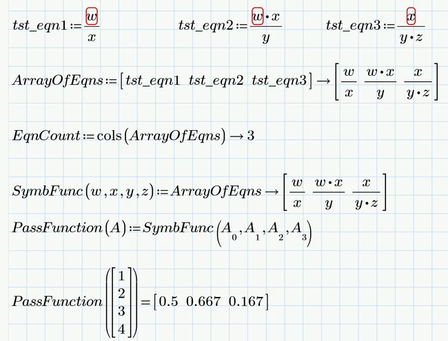

hi @LucMeekes
I am passing array of equations into an Array
And then want to get this function in the form of matrix like below wherein A is the Matrix, which I want to pass to reference calculation worksheet, which is called within main worksheet.
It gives the error to check label.
Can anyone help me to understand and solve this.
I could do this in Mathcad 15 and now struggling in Prime.

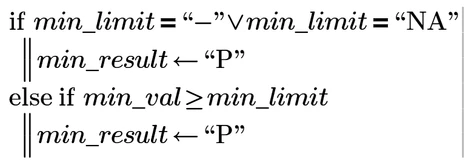

You are right that the behaviour of evaluating combined Boolean expression unfortunately has changed in Prime.
Mathcad used "short-circuit evaluation". This means that when three Boolean expressions are combined with OR, the first one is checked and if the result is "true" the others are not evaluated anymore because its clear that the whole expression must be "true".
Prime evaluates every single boolean and decides afterward about the result.
As you already noticed, the error occurs when the limit is a string because its not allowed to compare a string  with a numeric value.
So given that this is the expression which throws the error
on way to avoid the error is to split it
another is to wrap the last Boolean expression which could throw the error in a try and catch
Guess the first way is better readable.
EDIT: It just came to my mind that there may be a problem with both suggestions if "min_limit" is a string but neither "-" nor "NA".
The first workaround would throw an error in this case which is the same behaviour as MC15 would show
The second suggestion would return "true" in this case. Change the "1" to "0" and it always will return "false" in this case.
Of course you would also have to apply similar changes for the other combined Booleans wherever this error could be thrown as well.

Please attach your sheet. How should we see how the variables are actually labelled just from a picture?
We also don't see how you defined your ArrayOfEqns and the functions used therein.
If something worked in Mathcad (15), that doesn't mean it will work in Prime - unfortunately.
It may help if you also post a Mathcad 15 worksheet demonstrating that what you did worked in that version.
General advice: Global assignments should be used very sparely and with great care. Whenever possible (and its possible most of the time) avoid using them.

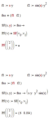

As Werner says, Mathcad Global Definitions should be used with great care, especially in Mathcad Prime which is not as permissive as the prior Mathsoft Mathcad.
However, I’d guess that your problem arises because you’re trying to define PassFunction with Global Definition whilst you define SymbFun using a standard Definition.
Mathcad looks at Global Definitions before standard Definitions.  Consequently, Mathcad will attempt to create PassFunction without knowing what SymbFun is.
Stuart
Mar 6, 2025 3:14 PM UTC
Well spotted, but then this would also not work in MC15 and fail with the very same error message.

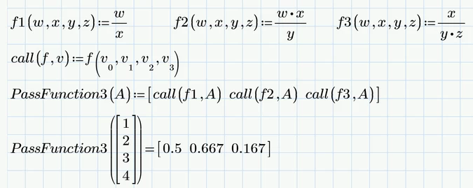

Attached is the Prime file,
Mar 7, 2025 10:26 AM UTC

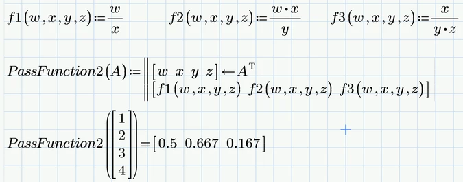

And you really claim that doing so worked in Mathcad 15? It doesn't !!
Don't use global definitions and it works OK
And then, why not simply
or
Was there any specific reason for using the global assignments?

For completeness sake here to show that what you tried does not work in Mathcad 15 either
