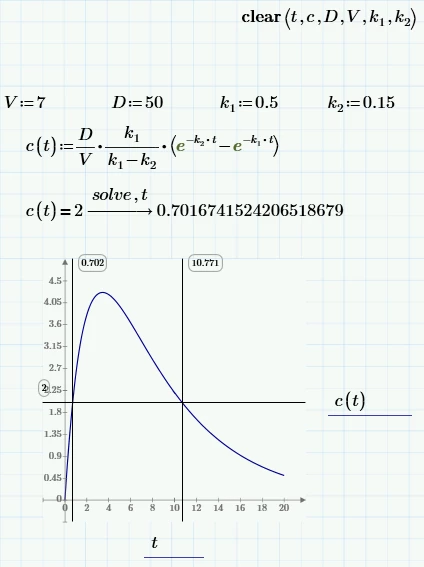

Could anyone tell me, why I'm getting just one solution when solving, when there are cleary two?
I already tried "solve, fully" btw.

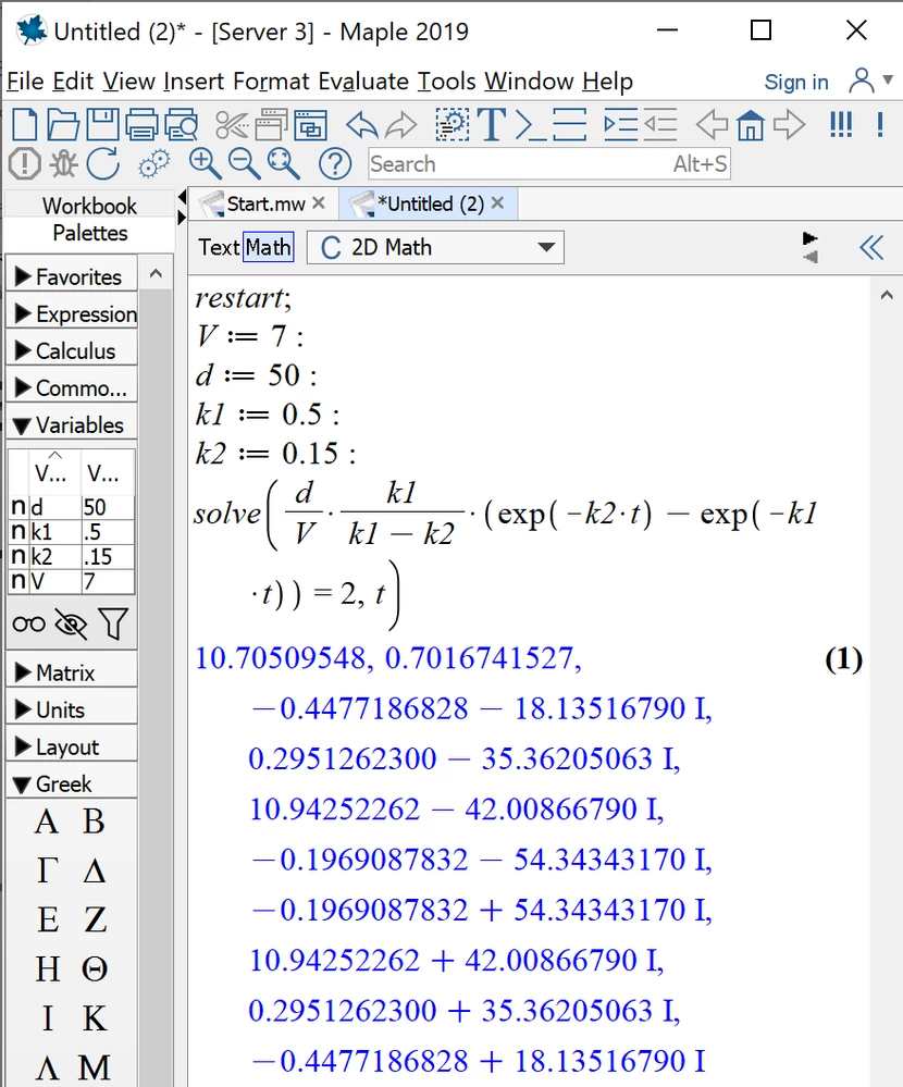

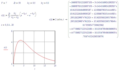

The question is legitimate, as there are 10 solutions (According to Mathcad 11):
What version of Prime are you using, and if using 6...did you choose the symbolic solver?
To get all real-valued t solutions for any target value of c(t) numerically, you can use:
Equivalent Prime(3.1) file is attached.

Yes, that's the 10 answers Maple (and Mathcad 11) give.

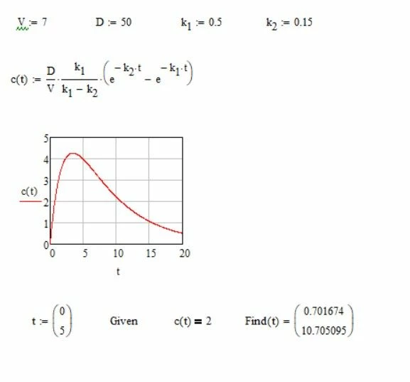

December 8, 2019

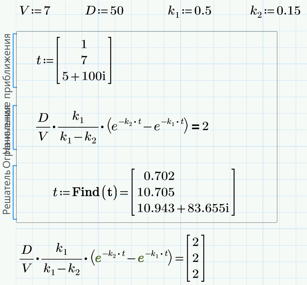

You could always use the numerical solver with more than one initial guess:

In the good old days Mathcad used Maple for its symbolic calculations and as you could see in Luc's post (with MC11 and Maple) Maple is able to find all solutions.
More than ten years ago Maple was replaced by MuPad and this was a big step backward. When Maple is not able to find an exact solution it switches to its own numeric mode and returns the first solution found. Modifiers like "solve, fully" or "assume,t>5" have no effect.

So if you need other solutions than the one the symbolic is returning, you have to resort to Mathcads numeric methods (solve block or the root command) where you have more control by providing different guesses or a different range for root to look for.
