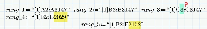

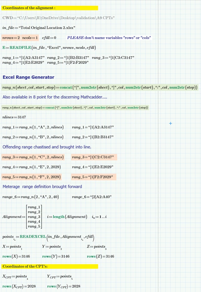

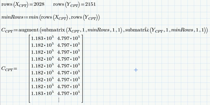

You get different lengths for X.CPT and Y.CPT because you obviously specified wrong ranges!
I'm rarely confident enough to opine that something is "obviously" wrong. However, I did notice your comments but left the ranges alone until Yusra came back with her response to your questions.

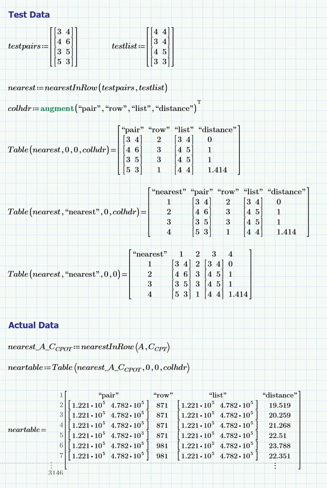

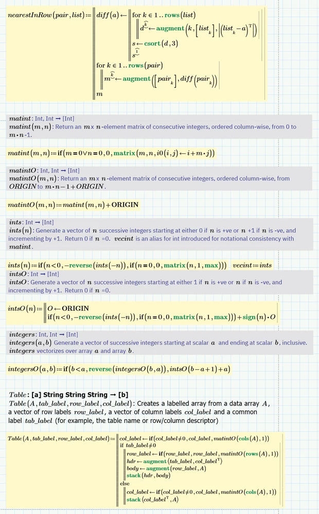

@YA_10963798  Please, pretty please, can you change your variable names "rows" and "cols" to something like "nrows" and "ncols"?  I keep forgetting that you've redefined these functions and spend ages hunting down what I think is an error on my part until I finally (re)notice that rows doesn't mean what I think it does.
I removed the header information from the "nearest pair" array and passed it instead to one of my Table functions, modified for ORIGIN independence.

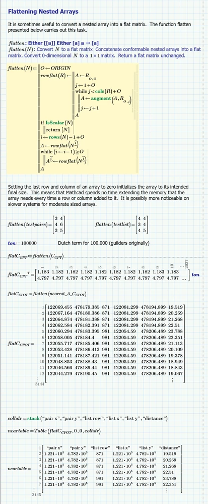

But I did find one variant of my mega unnesting function that we mentioned in the recent Kinematics thread.  The variant was a little too complex for most needs, so I've remodelled it to do basic one-level unnesting.  It's just a glorified version of the one I special-to-type function I posted in the kinematics thread, modified for (what I think is) ORIGIN independence (I hate making things origin independent; it makes my brain hurt, and I'm always hunting for missing ORIGINs).
Anyway.  Rather than rework something that works (not everybody has my vices!) then, it might be a lot easier to do as we discussed on the recent Kinematics thread = hammer any offending nested arrays into shape by flattening them until they see the light and become matrices.  Meet the hammer, suitably modified for ORIGIN independence (I think) ...

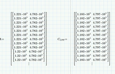

BTW, did you really intended to create A and C as those nested matrices?
Could be done much simpler by using
This only works because X and Y have the same length.
I was a bit confused to see that X.CPT and Y.CPT have a different number of entries.
For the creation of C.CPT you used the minimial number (in this case the lenght of X.CPT) and so you are ignoring the surplus values in Y.CPT.
Is this really as it was intended and as it should be?
Of course we still can create a coordinate matrix similar to the one you created, but not nested

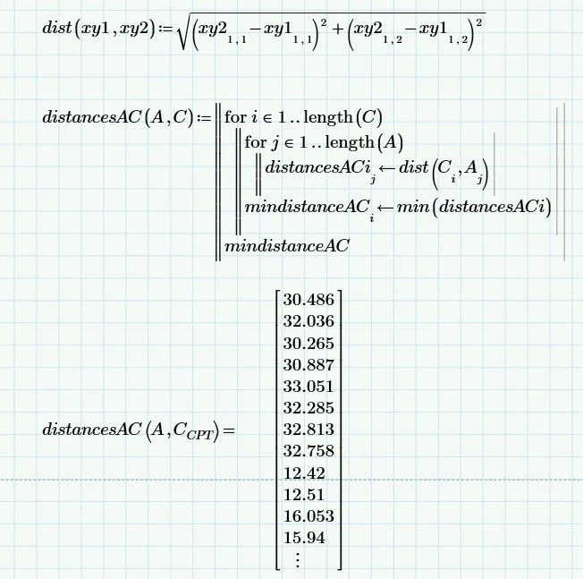

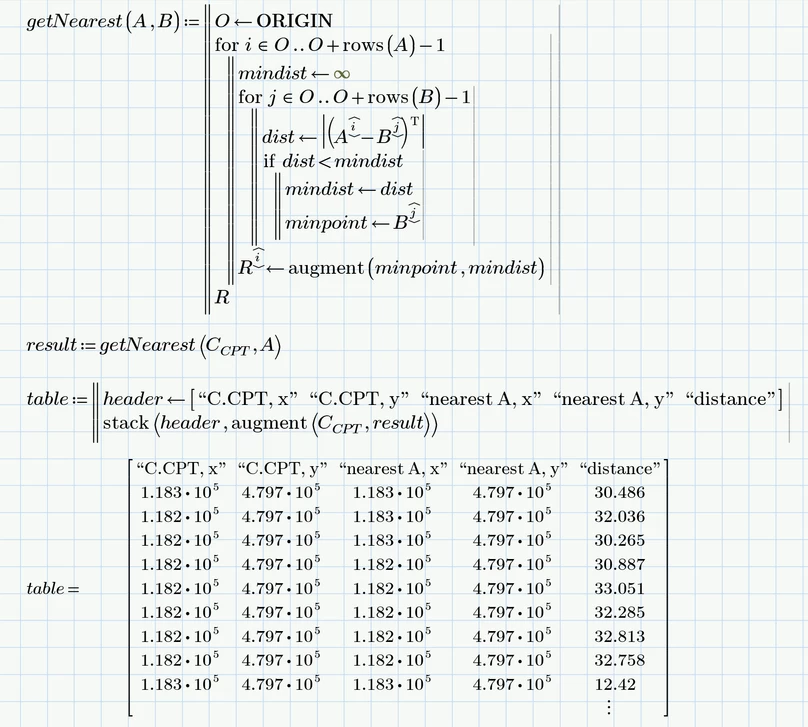

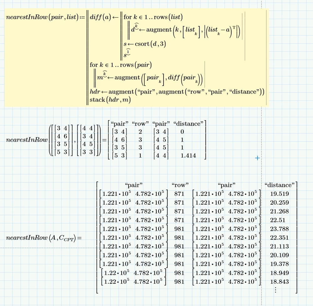

Here's a brute force and ignorance program in Mathcad Prime 10. You can choose which column(s) you want to actually use or return.  It is blisteringly slow on your data set ...
The transpose of the difference in function diff is to convert the difference to a vector thus allowing use the abs operator.
Stuart

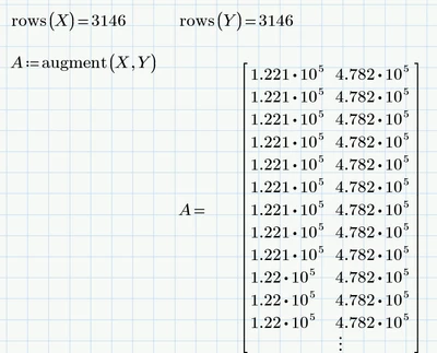

Here is a first attempt to your question.
I corrected the wrong rang_5 string so now X.CPT and Y.CPT are equal in length.
I also unnested your A and C matrices as already decribed.
But only the first(!) point in A with the minimum distance is returned, not a whole list of all points in A with the same minimal distance.
If you really need a full list of A-points for every point in C, you would have to specify the data format you want the result to be.
Prime 9 file attached

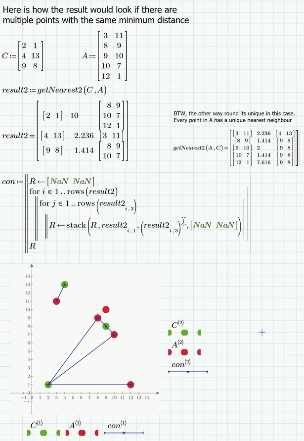

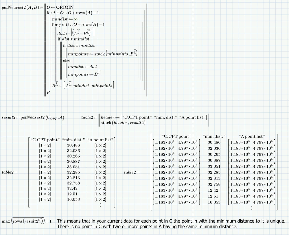

I changed my "getNearest" so it would return ALL points in the second matrix with the same minimum distance.
But in your data there is no point in C.CPT where two or more points in A would have the same minimum distance.
So with this data 'nearest point' is uniquely defined.
Here is what it might look like if the nearest point is not unique
Prime 9 sheet attached
