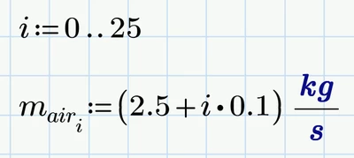

Don't use the vector index "i" at m.air (or use it at m.air AND Th2)

In your case the reason for the error seems to be that you did not consider the difference between a range and a vector.
A range is just kind of an implicit loop, its NOT a collection of various values!
Her one way to define m.air as vector, not as range (assuming that ORIGIN is at its default value 0)
Note that the "i" is a vector/matrix index, not a literal index as "air".

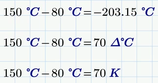

When displaying the result of the difference of two temperates given in °C, you should not use °C but rather Delta°C (equivalent to Kelvin).

You did not write a vector index i when defining m.air but rather renamed the variable in mi.air.

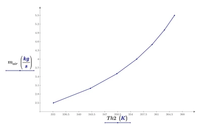

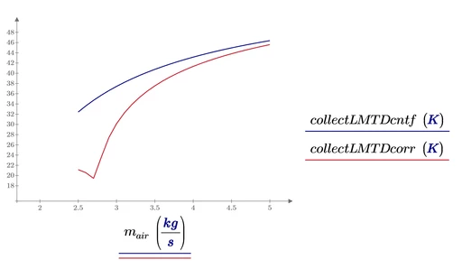

And when you call the function F_CrossFlowHX... you have to use vectorization (the arrow over the expression) to apply the function to every element in he vector.
As your function return a 2x5 matrix, you get a nested vector with 26 elements, each of which is a 2x5 matrix.
When you talked about plotting in your initial post - did you had something like this in mind?
See the attached worksheet.
