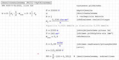

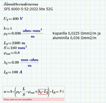

I tried to find a solution this but so far no results. This works in Smath as is, but now I'm trying to transform all my formulas to new software, Mathcad does not seem to like how it is calculated.
Can you tell me what I should do to make it work?
lamda2*L2 can be calculated separatedly, but not within the formula..

Your definition of lambda.2 in Prime has the wrong units!
It should be milliohm/meter but you defined it as millimeter * ohm / meter
miiliohm is not predefined in Prime. So you may write 10^-3 ohm.
If you need it more often in your sheet, it may be a good idea to add the definition of that unit by typing
You can hide that definition at the top of the sheet either to the right of the first page margin or in a collapsed region.
For consistency the left hand side of the definition should be labelled as "unit" (so its typeface is turned bold blue).
You get the Omega (looks better than writing "ohm") by typing a capital W and immediately follow it by pressing Ctrl-G (for "Greek").

Thanks you spotted a mistake, it should be L2 also. I was so blind! But unfortunately it did not solve the problem.
May 20, 2024 11:57 AM UTC
In the brackets you need the same units to be added together

This is how it looks like in Smath
