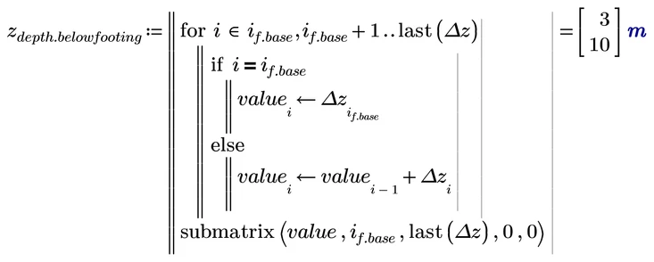

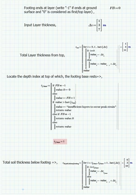

Thank you @Werner_E , @Perez  and @ttokoro for your generous solution. I am trying to make a soil settlement calculation sheet based off mathcad. I am having some issues in getting the total depth of soil thickness beneath the footing. In my worksheet, what I have done is if the footing base rests on the top surface, the value of FB is "-1" and "0" and so forth for the layers from top till bottom. I made a variable "z.depth.below.footing" to find the total soil thickness below the footing base.I realized when I put FB=0, it means that the footing base is resting on the first layer. It means it should have only two layers  beneath the footing base. However, inthe the sheet I see an extra value of "0" in the "z.depth.below.footing" output matrix. Please advise how to solve it.

Maybe that way? Is this what you are looking for?
Your approach works equally well if you shift the indices of value accordingly
or, maybe simpler and straightforward, leave your approach unchanged and simply cut off the values below index i.f.base using the submatrix() function:
And her two last ones 😉
