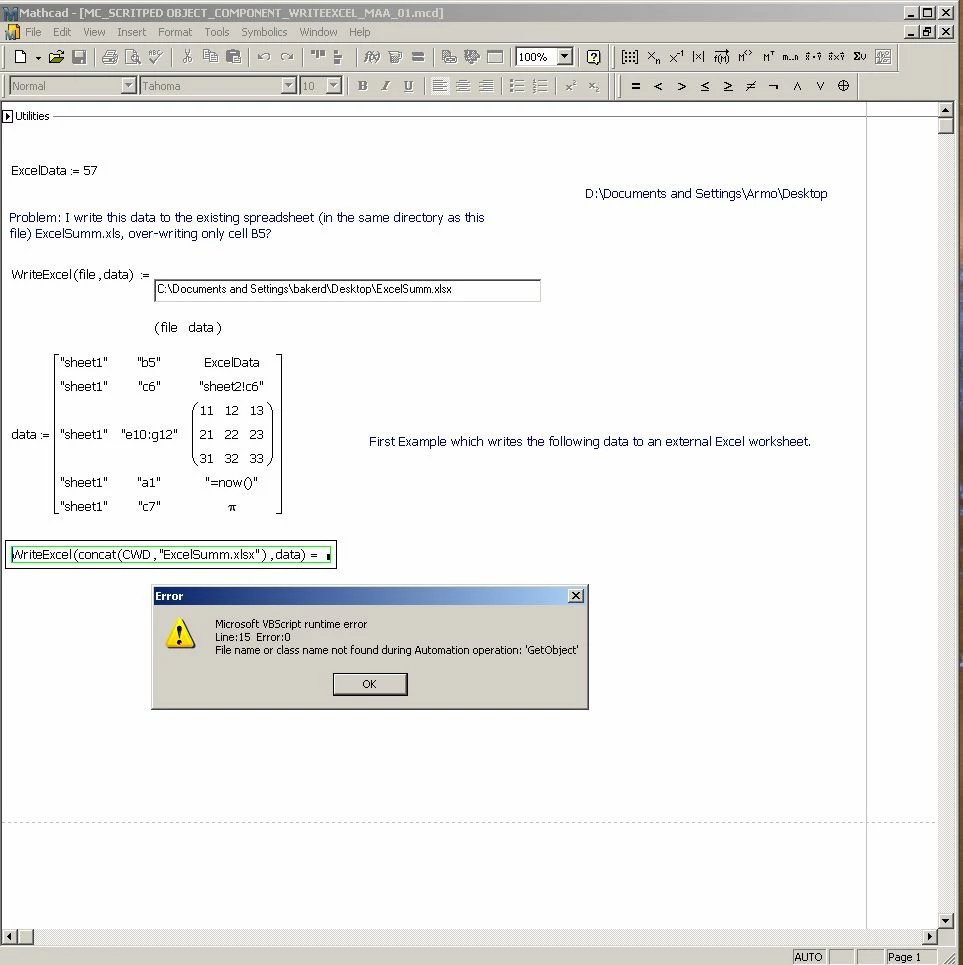

Thanks for the input Mike. I can't get the script to run in my mathcad although. I've attached a JPG of the error which seems to indicate that there is something wrong with the VBScript in the component. I've gone through the script, changed the file location in the text box and looked at the Developer's reference but I can't see what is causing the error.
Regards
Doug
January 14, 2011
Have you created the Excel file.
I think the file has to be created first.
