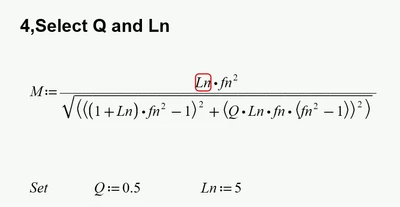

I think there is no need for you to manually change any labels.

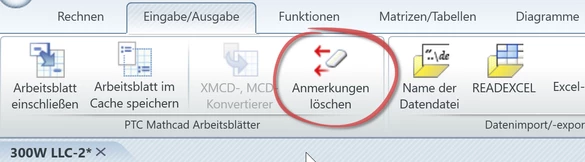

Simply load the converted file in Prime and press F5 or F9 to let it recalculate. Doing so will automatically label the units correctly.
What remains are red line and arrows indicating that something has been changed and may no be displayed differently in Prime. You can ignore these annotations and remove them (ribbon Input/Output, Delete Annotations)

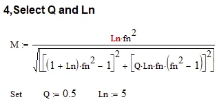

The remaining errors like this one (Ln is not defined)
are present in the original file as well

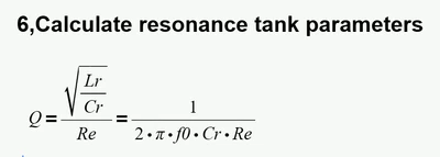

Mathcad is here used just an equation editor for reference purposes only, not for doing any calculation. It would have been better to use the Boolean equal sign (the fat = )  here instead of the assignment operator (:=).
Especially the expression in chapter 6 could be made much better looking that way

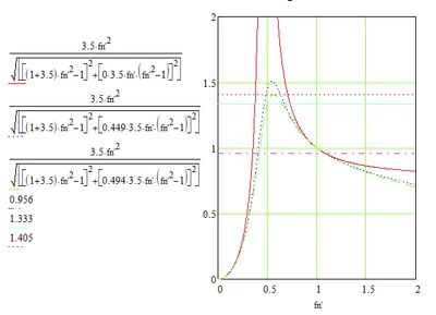

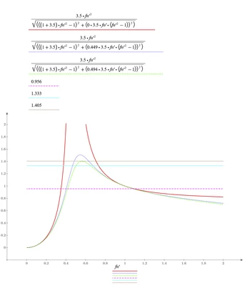

Maybe you also want to reformat the plot as it looks a bit differently in the original
You may use a smaller typeface to gain more horizontal space for the traces and/or you can move the y-axis expressions to a different position (something which could not be done in good old  real Mathcad).
The three horizontal line which are realised as separate plot traces could be replaced by adding horizontal markers, so there is less room used for the y-axis expressions.
The plot in the original file shows a grid. The native plots in Prime unfortunately do not provide any means for grid lines.
If you need grid lines, you have three options:
1) Manually add them one by one using the option to add horizontal and vertical markers (something that I would not do voluntarily)
2) Use functions which were posted here in the past by LucMeekes and me which create a data structure which when plotted draw the grid lines
3) Don't use Prime's native plots but rather redo the plot in the Chart Component - a badly integrated third party tool. This is really slow, awkward to use and does not support units but it provides some features the native plots are missing, amongst them grid lines, secondary y-axis, etc.
