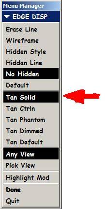

13.)Tracy, you may or may not know that there is another selection in
the Edge display menu that you can use. You may have already tried this
but in case you have not or are not familiar with this I will share.
If there are too many hidden lines to remove then, instead of doing a
hidden line removal, select "Tan Solid" and only select the component
parameter entities. The process is the same as removing lines except you
select the lines you want to keep.
