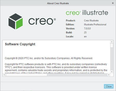

What version of Creo Illustrate are you using?
7.0.0.0
