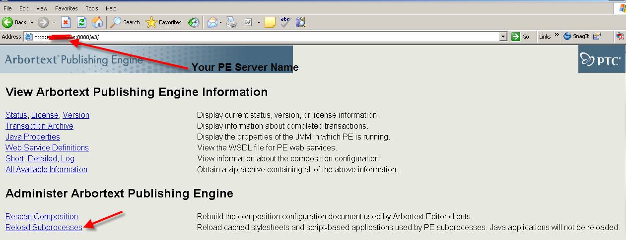

I should add that every once in a great while, PE clutches a stylesheet and
won't let go and a restart *is* required. It's very rare, though, and
inevitably I spend an hour or two scratching fruitlessly at the dirt before
thinking, hmmm, this is one of those times.
Paul Nagai
My experience is that we always have to restart the server. The only time I don't is if it's a FOSI that isn't used very often (Japanese, for example). But then, we're doing 30-100 compositions per hour, so PE rarely lets go of a FOSI.

Do you think PE would hold onto z_dev.fos if you were the only one using it?
I'm not the one who maintains PE, so I don't know what z_dev.fos is. But I do maintain the FOSIs and I know that even if PE is not running any compositions, the two instances of Epic.exe running keep a copy of the FOSI and I need to restart the server so that it reads a new version.
When you say "restart the server", do you mean a literal restart, or just a 'toggle' of Tomcat?

I meant that I restart Tomcat.
I have occasionally heard from other people that they *must* restart PE any
time they update a stylesheet. I do not know why this is sometimes the case.
I have great "luck" deploying the three versions of my stylesheet, updating
them, and using them without Tomcat restarts.
Saying it another way, I deploy these three stylesheets and restart Tomcat:
app.fos
z_dev.fos
z_test.fos
At initial deployment, they are all the same.
During development, I constantly update z_dev.fos (it could be z_dev.style,
too). Without a Tomcat restart, PE re-reads z_dev.fos picking up my latest
changes and then composes. When I'm done, I delete z_test.fos. Copy
z_dev.fos and rename it to z_test.fos. Now, when my test/qa authors check my
work, they use z_test.fos and PE again re-reads z_test.fos and uses it for
composition without a Tomcat restart. When they approve, I delete app.fos,
copy z_test.fos, and rename it as app.fos.
I can't remember exactly, but I have this vague recollection that John
Dreystadt or John Lloyd explained some of the subtleties of how/when a
stylesheet gets re-read.

An easy way to reload your style sheets if you are using PE 5.3.
Brian York
Exmark Mfg. Co.
It may be dependent on the version of PE, or even of Tomcat within a given PE version. Our oldest PE server, therefore our oldest install of PE, is much more forgiving than our newer or newest. So much more so, that our folks who've been using Arbortext the longest have had a little trouble believing that the newer installs need a Tomcat 'toggle' as often as they do.
And that's not necessarily a difference like PE 5.2 to PE 5.3, but appears to be from a very early 5.2 install to a very late (nearly time for 5.3) install, even though the same Mxxx. The Tomcat versions are different (5.0.28 to 5.5.12), even though the PE version is the same.
Just two cents,
