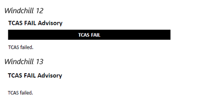

Hi, my company uses the block structure in certain Arbortext content. Recently, we migrated from Windchill 12 to 13 and lost this formatting/text when publishing.
We are using Arbortext w/ Styler 8.2.3.0. Please let me know if you need additional information.

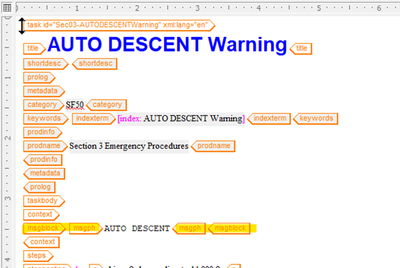

Hi, I am still unable to resolve this issue. Here are more details:
Viewing content in Arbortext w/ Styler 8.2.3.0, the topic displays as expected:

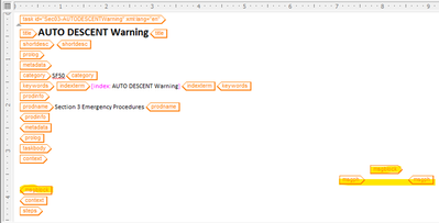

However, when I open the stylesheet for this document, the display changes to this:
The text "AUTO DESCENT" remains in the msgph element as white text. When published to pdf, the output displays as follows:
Previously, using Arbortext 8.1.1.0, the topic would publish correctly:

The Error Log lists this for that particular page in the published PDF:
<Record date="Tue Sep 30 11:58:38 2025" millis="1759251518"
severity="error" suppress="0">
<Level>ERROR</Level><Message>Pg 42 Javascript: TypeError: formatting.currentTableCell
is null Font([object fStreamPos],true)@_gte:Font:96 _cellfont([object
fStreamPos])@_dtd:_cellfont:1 . [1500] (2:"_dtd:_cellfont"#0) (1:"editorDom0"#{1;/RDStyle/ResolvedMap/bookmap/part/topic[1]/topic[4]/topic[1]/body/context/msgblock/#_app:Gentext/_sfe:BeforeOrAfterText/table/tgroup/tbody/row/entry/_cellfont})
</Message>
</Record><Record date="Tue Sep 30 11:58:38 2025" millis="1759251518"
<Level>ERROR</Level><Message>Pg 42 Javascript: _gte:Font:96: TypeError:
formatting.currentTableCell is null . [1500] (2:"_dtd:_cellfont"#0)
</Message>
fStreamPos])@_dtd:_cellfont:1 . [1500] (2:"_dtd:_cellfont"#0) (1:"editorDom0"#{1;/RDStyle/ResolvedMap/bookmap/part/topic[1]/topic[4]/topic[2]/body/context/msgblock/#_app:Gentext/_sfe:BeforeOrAfterText/table/tgroup/tbody/row/entry/_cellfont})
</Message>
</Message>
fStreamPos])@_dtd:_cellfont:1 . [1500] (2:"_dtd:_cellfont"#0) (1:"editorDom0"#{1;/RDStyle/ResolvedMap/bookmap/part/topic[1]/topic[4]/topic[3]/body/context/msgblock/#_app:Gentext/_sfe:BeforeOrAfterText/table/tgroup/tbody/row/entry/_cellfont})
</Message>
</Message>
</Record>
