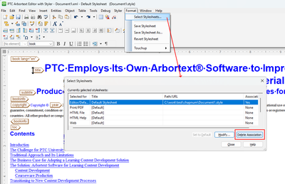

Hi @PV_12583628,
Anurag
You can do this by opening the document, selecting Format->Select Stylesheets... from the menus, and clicking "Delete Association" in that dialog.
