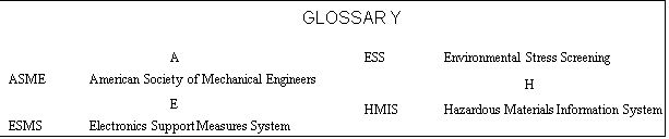

I am having problems formatting a glossary. I need my glossary to have two columns with space between them.
The 1<sup>st</sup> column should have the acronym and the second column should have the meaning.
My current out put looks like this:
BRBS Be right back soon
LOL Laugh out loud
What I want is this:
LOL Laugh out loud
The “Be right back soon, and Laugh out loud. Should be aligned left. I tried quadding with no avail.

Nichole:
Looks like you want an alignment group or a "kernto" setup. If you
really mean two columns you probably need ALGROUP like this sample:
FROM DTD:
FROM FOSI:
<e-i-c gi="glosslist">
<charlist inherit="0">
<textbrk startln="1" endln="1">
</charlist>
</e-i-c>
<e-i-c gi="letter" context="glosslist" occur="all">
<quadding quad="center">
<presp minimum="8pt" nominal="10pt" maximum="12pt">
<postsp minimum="6pt" nominal="6pt" maximum="6pt">
<keeps next="1">

Input:
Output:
