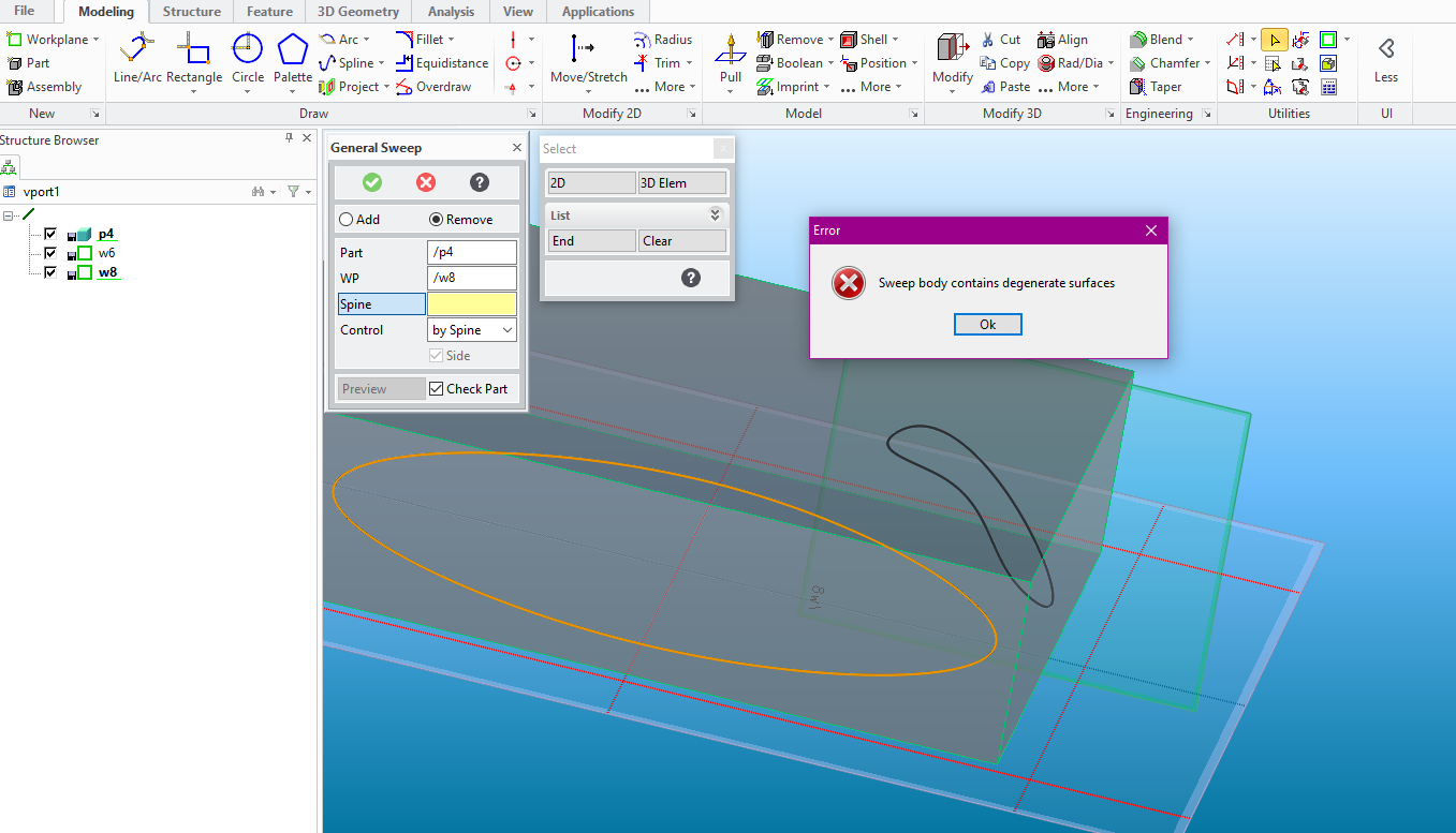

can someone please tell me what this error message mean? I am trying to create a profile using sweep remove command.
Thanks!
Anar
Solved! Go to Solution.
If the shape of the geometry being swept intersects with itself, it will create a degenerate surface.
