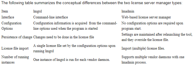

Very confused here.   Why am I given a choice, whats the difference, and whats the default, and whats recommended?  After reading assorted docs for hours I still don't know what to do.

    both license manager run as service on license server.
    1.] service FLEXlm server for PTC
    running processes ... lmgrd.exe (2x) and ptc_d.exe
    you can manage this service, when you are logged on license server, only
    2.] service lmadmin_ptc
    running processes ... lmadmin and ptc_d.exe
    you can manage this service from any workstation via FLEXnet Admin Web Interface
    Personally I use FLEXlm server for PTC, because it is available for a long time and I know it very well.

    I gave a talk in 2014 on license management. The last part of that covers the new license manager.
    This is a link to the complete talk on the old PTCUser site. The talk is also someplace on this site, just not the full powerpoint or pdf.
    http://portal.ptcuser.org/p/do/sd/sid=2464&type=0
    It has advantages.
    • You get a website to manage the license
    • You can update the ptc.opt file without stopping & starting the license
    • You can return borrowed licenses early
      I didn’t have complete information on returning borrowed licenses at the time. Subsequent calls with PTC has provided additional information on that.
      https://support.ptc.com/appserver/cs/view/solution.jsp?n=CS31332
      The error "lmremove: You are not a license administrator. (-63,199)" is probably because the version of the license server is not of the latest version (11.11.1)
      Changes in server.xml file i.e.
      licenseServer adminOnly="true" .................... licenseReclaimAllowed="false" to:
      licenseServer adminOnly="false" ................... licenseReclaimAllowed="true"
      is already incorporated in version 111.1.1 , however for 11.10.1 it has to be done manually , hence the error.
      This has to be done prior to borrowing the license.

    Thanks guys these are all the correct answers.  Even tho I am most familiar with the old LMGRD I have been pretty unimpressed with it.   I am going to go with the new web based version, especially since my host server will be offsite.   Thanks for the replies.
