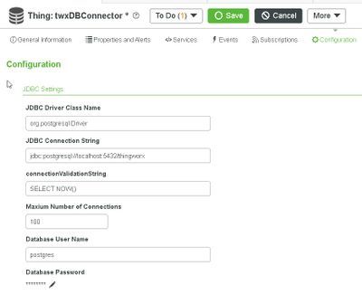

The twxDBConnector thing is based on the PostgreSqlServer template, that is present in the Relational Databases extension. It has 4  main services:

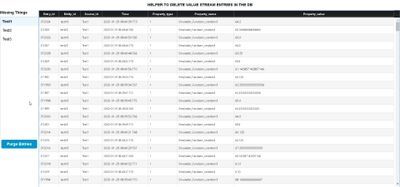

getEntriesToPurge:  Queries the TWX DB for all the entries related to a Thing. It does not consider the ValueStream id, so it will purge all the entries across all value streams. Requires a Thing name as an input;
getMissingThings: Queries Things that are present in the ValueStream DB table that are not present in the Things table, meaning that they were deleted;
purgeThingEntries: Purges the entries related to a Thing. It does not consider the ValueStream id, so it will purge all the entries across all value streams;
purgeAllEntries: Purge all the entries related to Things that were deleted.

I also added a sample mashup that leverages the services.
The twxDBConnector has a configuration table that requires the DB Connection string, user and password.
