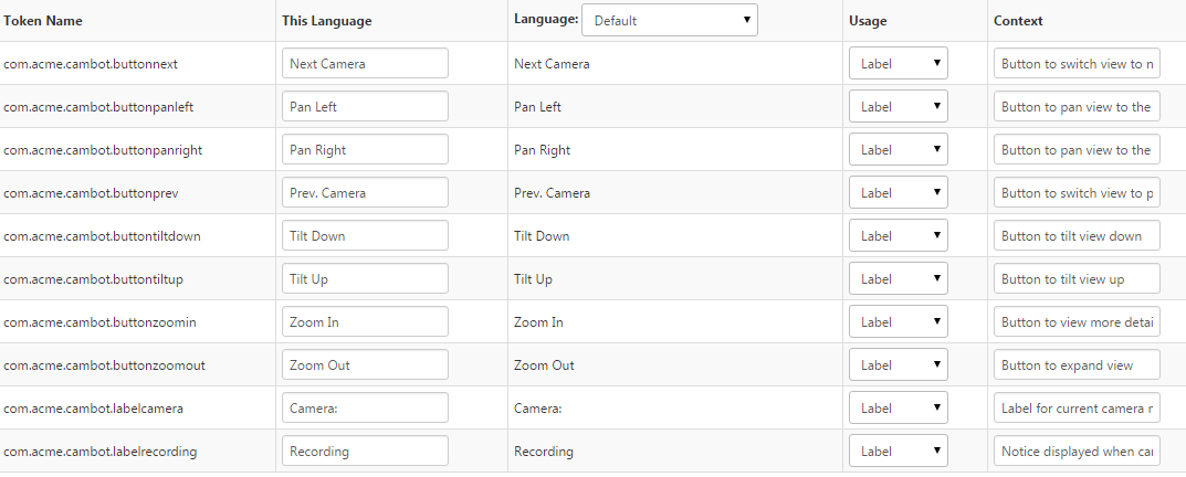

Once the table has been created and saved, you can edit the translated text in Composer. Under Entity Information, select Localization Tokens. A grid similar to this will appear:
The columns shown are:
  • Token Name. This is the symbol used by mashup developers to insert a localized string into a certain place in a widget. For example, no matter how the phrase "Add New Page" is rendered (Neue Seite hinzufügen, Adicionar nova página, 새 페이지 추가...) the application developer is only concerned that the token addNewPage appears on the proper widget. See How tokens are resolved below for more information.
  • This Language. How the text is to be represented in this language, that is, the language of the Localization Table currently being viewed or edited.
  • Language. How the text has already been represented in any other language currently defined on the system. This is simply for reference purposes, to compare one translation with another.
  • Usage. Can be set to Label, Message, or left unspecified. This is a guide to translators, who have to be concerned about the size of translated text. Usage Label suggests that the text needs to fit in a confined space, such as in a column header or on the face of a button. Usage Message suggests that the text is meant for a popup, error message, help, or somewhere that full sentences can be accommodated.
  • Context. This is a free-form text field to provide instructions, advice, context, or other explanatory material to the translator. For the token book, for example, the context field can distinguish between the senses of book (something to read), book a table, book a sale, or book a prisoner, which may all have different translations.
Translations can be entered in Composer. However, it's also likely that a third-party translator will do the work without using this editor. See Tips for translators below.

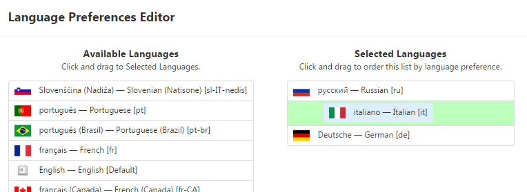

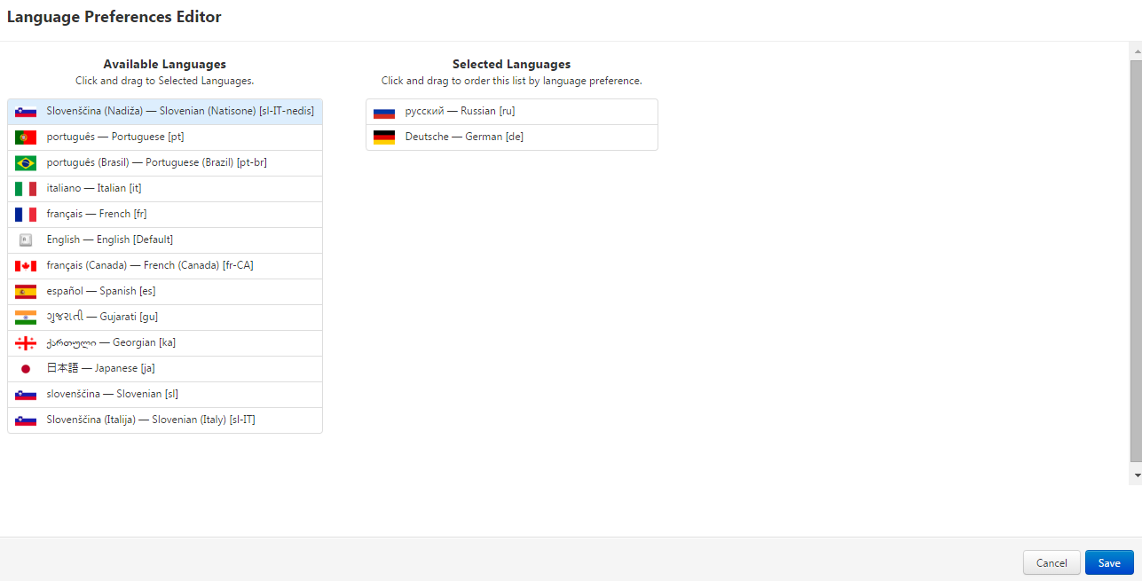

Define language preferences for a user
The reason for localization is to present user interfaces in the best language for a given user. To support this, each ThingWorx user is associated with one or more languages – those that that user can read comfortably. Some applications might offer just one language or a few, some many, and the supported languages may or may not overlap. So each user defines an ordered preference list, saying in effect: my best language is Catalan, but I'm decent in Spanish, and if those aren't available I did spend a few years in Hungary, and as a last resort there was some French in school. This would be represented in ThingWorx as: ca,es,hu,fr. A user from Scotland might have language preference en-UK,en, meaning that English with United Kingdom spellings and vocabulary is best (tyre, windscreen), but if not available then any English will do (tire, windshield). (It is not necessary to spell out related preferences of this type – see How tokens are resolved.) Any application then interacts with a given user in the best language that the application and user have in common.To define the language preference(s) for a user, open the Users list in Composer:
Then choose an existing user to edit, or click New to create a new account.
The only localization related information here is the Languages field. An administrator who knows the names of available languages may edit or paste an ordered, comma-separated list into the Languages field (e.g.  ca,es,hu,fr-CA). Clicking the Edit... button brings up a drag-and-drop preferences editor:
The column on the left shows available (unselected) languages. The column on the right shows this user's languages, with the top entry being the most preferred language. Dragging a language from left to right adds it to the user's list; from right to left removes it; dragging rows up and down on the right changes the preference order. As language entries are dragged, a highlight appears to show where they might be dropped:
A user with no language preference set will have all tokens resolved from the Default and System tables. Language Preferences can be set programmatically, as detailed in KCS Article CS243270.

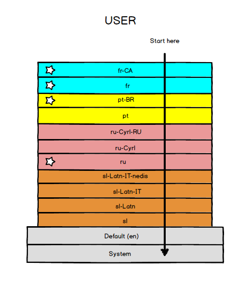

What happens at run time when the UI needs to display the value of a localization token? The answer is determined by
  • the current user's language preferences
  • the set of Localization Tables configured on the system
  • the presence or absence of a translation for a given token in a given table
To visualize this, picture the user's language preferences as a stack, with the most preferred language on top and the least one sitting on the floor – where the floor consists of the Default and System Localization Tables:
The user's language preference is fr,pt,ru,hi (French, Portuguese, Russian, Hindi, with French most preferred). The system is configured with Localization Tables, which have no order, for it (Italian), fr-CA (Canadian French), ru (Russian), pt-BR(Brazilian Portuguese), es (Spanish), and the default (likely Engish). Now the UI needs to present this user with the best value for the token com.acme.spiffy.labelAssembly.
To resolve this, we start at the top of the stack. Is there a fr Localization Table? There is. Does it contain a translation for com.acme.spiffy.labelAssembly? For the sake of illustration, assume that it does not – perhaps other applications have French support, but the Spiffy application doesn't, so there aren't any com.acme.spiffy.* tokens in the French Localization Table. So we still need a value. Continuing down through the user's preferences, the next acceptable language is pt. Is there a pt localization table? No. There is a Brazilian Portuguese translation, but that won't help a user from Portugal. Still looking, we move to the next language, ru. Is there a ru Localization Table? There is. Does it contain a translation forcom.acme.spiffy.labelAssembly? It does: Ассамблея – so the token has a value, and that is what gets displayed in the UI.
Suppose that the user's preferences were more specific, something like this:
The users's language preference is fr-CA,pt-BR,ru-Cyrl-RU,sl-Latn-IT-nedis (Canadian French, Brazilian Portuguese, Russian in Cyrillic characters as used in Russia, Slovenian in Latin characters as used in Italy where the Natisone River dialect prevails). ThingWorx treats this by internally expanding the stack to include acceptable fall-back languages. In effect, it looks like:
Of the four languages that the user can accept and that the system defines (fr-CA, fr, pt-BR, ru) the first one containing the desired token determines its value in the UI.

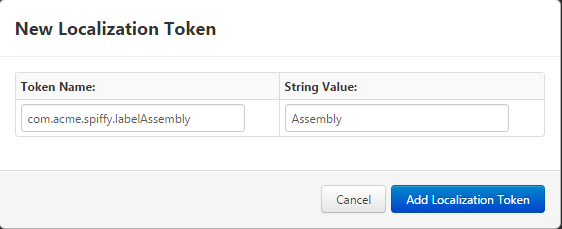

and then click "+ Localization Token" to add a new one. A dialog opens prompting for the token name and its default (English) value:
Note that the token name has been namespaced for two reasons: to prevent conflicts with tokens from other sources, and to allow the developer and translators to work only with application-specific tokens. On clicking "Add Localization Token," the token is created and the default value saved. The mashup builder now shows: localization_blog_pic22.png.
After all of the tokens needed by the application have been defined, they and their values may be seen on the Localization Tokens editor for the Default Localization Table. By entering the namespace prefix in the filter textbox, the display can be restricted to the tokens for this application:

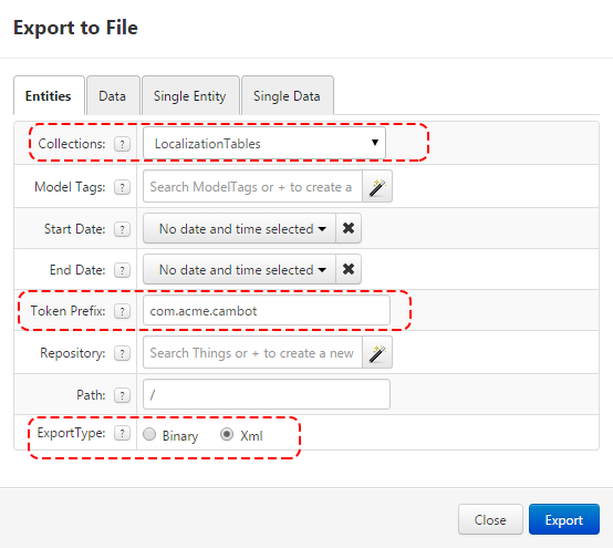

From the Import/Export menu, select EXPORT / To File:
Then, depending on the file format desired, choose either the Entities or Single Entity tab. For Entities, set the Collections value to Localization Tables, enter the namespace in the Token Prefix field, and choose XML as the Export Type:
This will produce a single output file, containing a Localization Table element for every language defined on the system – in this example, English, French, and Spanish -- but including only the com.acme.cambot tokens.
For Single Entity, choose the language to export, specify the prefix, and choose XML:
This must be repeated, once for each language, and creates a separate XML file for each. In either case, the translator should be supplied with the Default XML and the file for the language to be added. (Or, the tokens and values may be converted to and from other formats, depending on the requirements of the translation service. In any case, the translated values must be in the same XML format before they can be imported.)

Allowing users to set their own language preferences
It may not be practical for the Administrator to set the language preferences for each user. An application may elect to expose the preferences editor to the end user, so that each user may select from the available languages those that are useful.
To support this, ThingWorx Composer offers a Preferences widget in the Mashup builder. The widget may be inserted into any application wherever the designer chooses. It may be tied to a button or menu item, or simply appear in a layout with other widgets – perhaps along with application-specific preferences and other settings.
To use the Preferences widget, design a mashup for it to appear in. The minimal case would be a responsive page mashup containing nothing but the preferences widget.
Add the Preferences widget by dragging it into place:
A placeholder for the widget appears in the mashup:
The widget may be customized by setting various properties:
These properties are specific to the Preferences widget:
  • ShowClearRecent: Check this to include the option for the user to clear the Most Recently Used history. You may specify a localized tooltip.
  • ShowRestoreTabs: Check this to include the option for the user to set tab restoration to ask, always, or never. You may specify a localized tooltip.
  • ShowLanguages: Check this to include the option for the user to edit language preferences. You may specify a localized tooltip.
  • ShowUserName: Check this to label the preferences widget with the user's name.
  • ShowUserAvatar: Check this to label the preferences widget with the user's avatar, if one is defined.
  • Style: Style the preferences widget itself.
  • ButtonStyle: Style the Clear Recent and Edit buttons. These should probably be set to the application's primary button style.

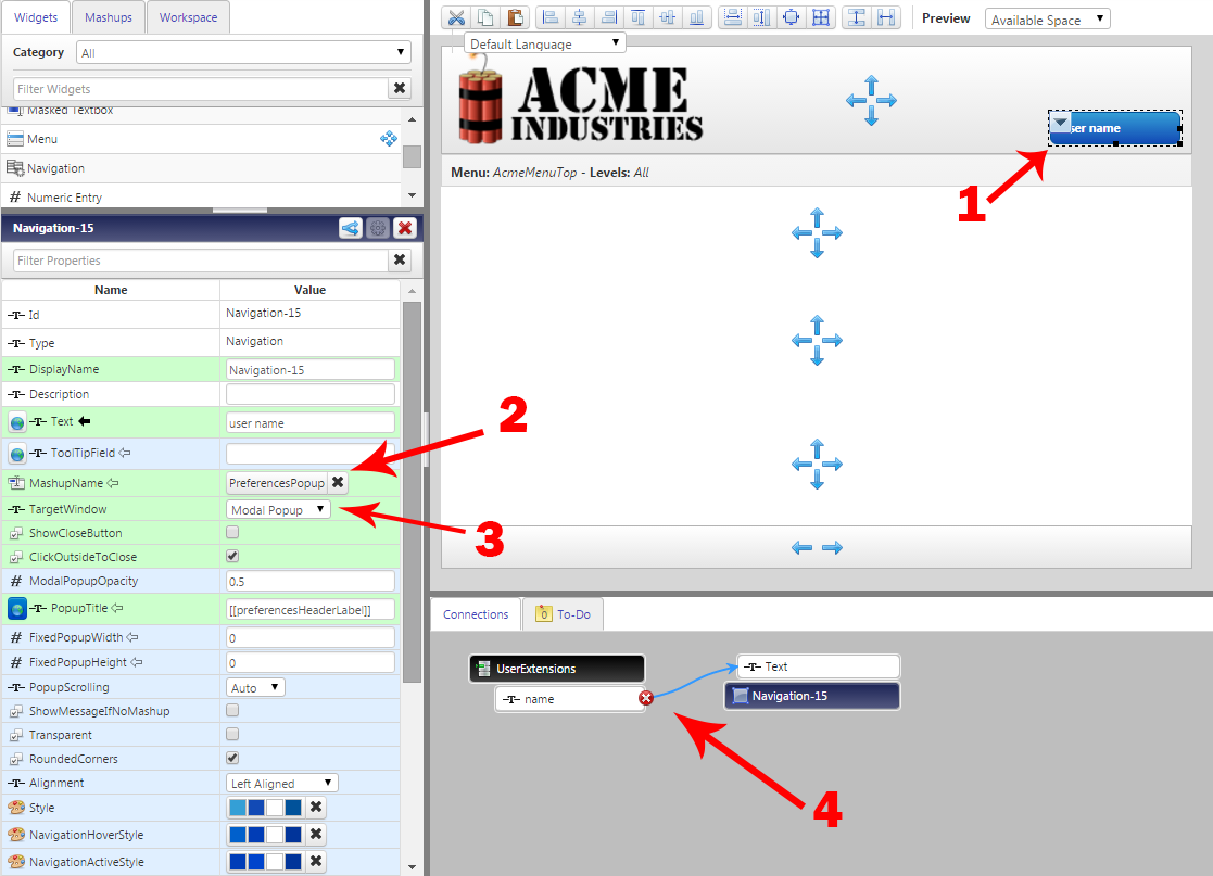

After adding the Preferences widget to a mashup, provide some way for the user to navigate to it, consistent with the application's UI design. The mashup may be tied to a menu entry, or assigned to a Navigation widget, or included in a page within the application's workflow – whatever suits the application design. Here is an example of providing access to preferences through a button in the application's title area:
1) The Navigation widget is placed in the page header.
2) The MashupName property is set to the mashup containing a Preferences widget.
3) The TargetWindow property is set to Modal Popup.
4) For a more interesting UI, the button label is bound from the user's name.
At runtime, the example looks like this:
Note that there is also a menu item leading to the mashup with the Preferences widget.
