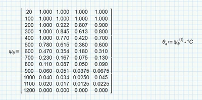

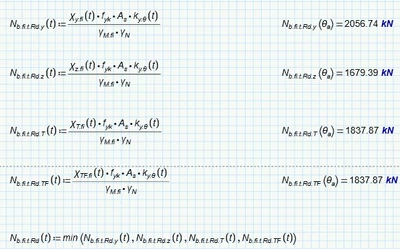

I have an issue with this equation below:
Here are the input:

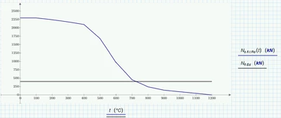

I can plot the data easily, but I cannot get the intersection point which im trying to with the root function.
It works in mathcad 15:

I found a solution for it by myself, by adding a guess before the root function.
