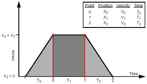

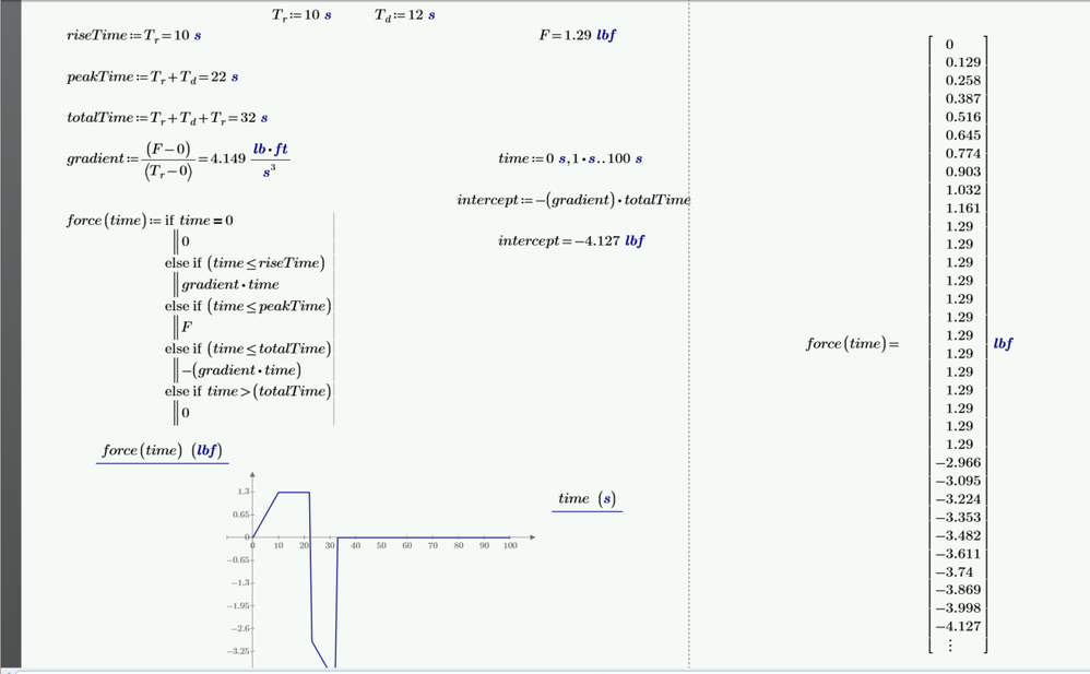

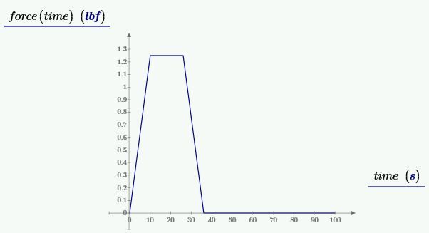

Hello PTC Community,
I have been trying to plot a piecewise function in Mathcad Prime 5.0 but cannot seem to get the desired result.
the mathcad's screenshot is attached. Please see what mistake am I making. Below the mathcad is the desired profile.my mathcadmy mathcadDesired profile (similar to this)Desired profile (similar to this)

Please include a post of your file.
Terry
the file is attached.

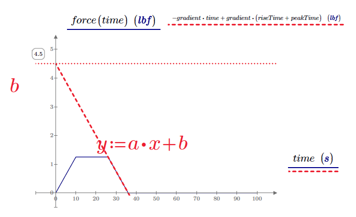

Hi
Plot as needed.
Terry
a:gradient
b:=totalTime/gradient
Cheers
