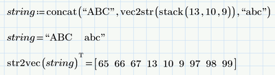

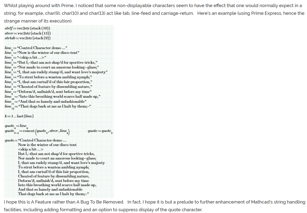

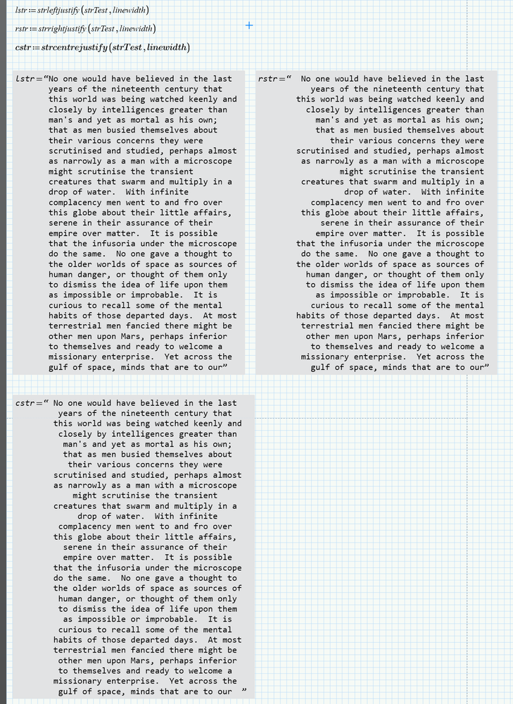

I was just playing around with the function format to see if I could create a readable, compact form that displays the values of variables in an expression.   To do this, I wanted to use the Unicode character point 10 or 13 to generate a newline.   This worked in Prime 10, and I'd previously used it to create string justification functions, such as:
Mathcad Prime 11 has broken this behaviour.  I now get:
Why did PTC do this?  Is it a bug that got introduced, or was it deliberate?  If the latter, what benefits accrue to the user that outweigh the loss of functionality?
I've been requesting more sophisticated strings since before Mathcad Prime was developed and throughout its entire existence—for example, HTML or RTF.   Taking even such a limited capability away is irritating in extremis.
Stuart

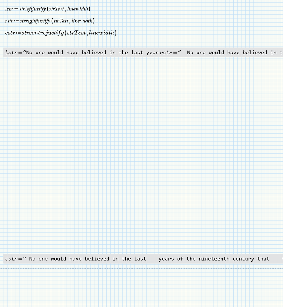

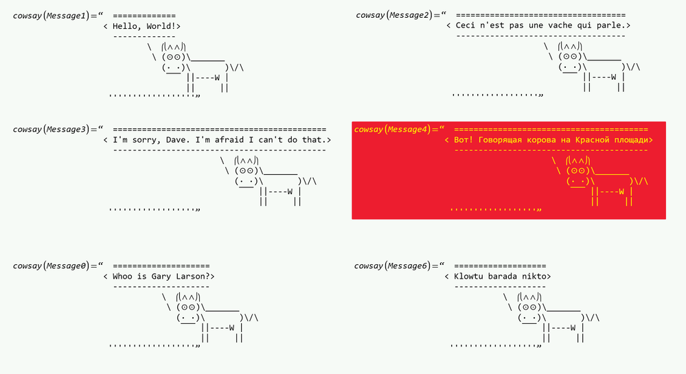

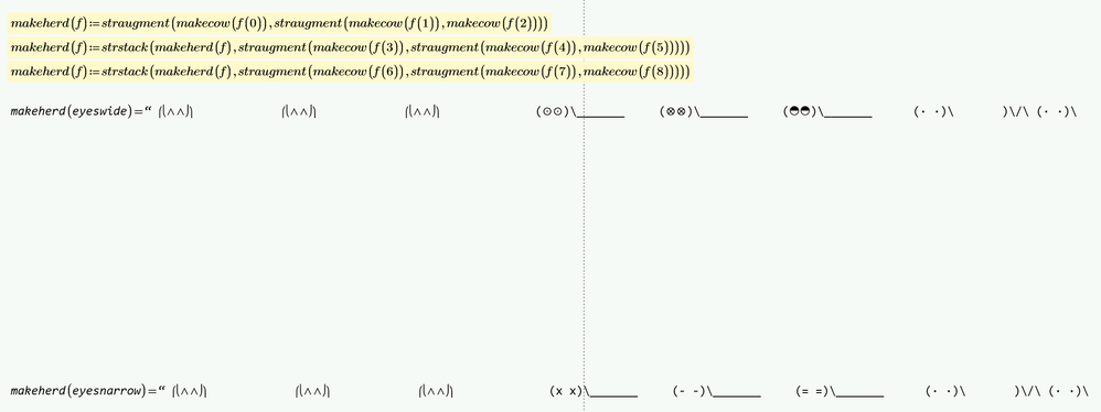

For the record, here's an example of the use of CR and/or LF that I posted almost 4 years ago (Prime 7, I think), so it's been in use for several versions of Prime and documented as having been used:
https://community.ptc.com/t5/Mathcad/Feature-Request-Remove-quotes-from-strings-in-format-function/m-p/749778/highlight/true#M197367

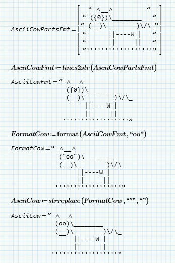

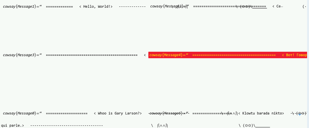

Here's a herd of Prime Milchkühe in 10.0.1.0 ...
And here's the same herd after being hit Cowvid Prime 11:

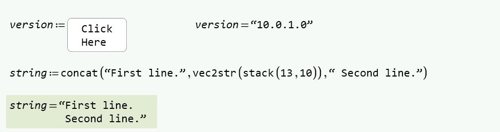

Prime 7..10
Prime 11:

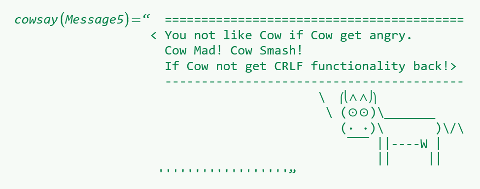

Somewhere in PTC Central, the minion in charge of Excluding Bruff's Beneficial Features is being summoned as we speak.  After a formal shaming, they will be ceremoniously dragged by wild tortoises to a place of execution, where they will commit ritual seppuku with a blunt parenthesis.  Their crime?  They let a Useful Feature slip through the net!
Stuart

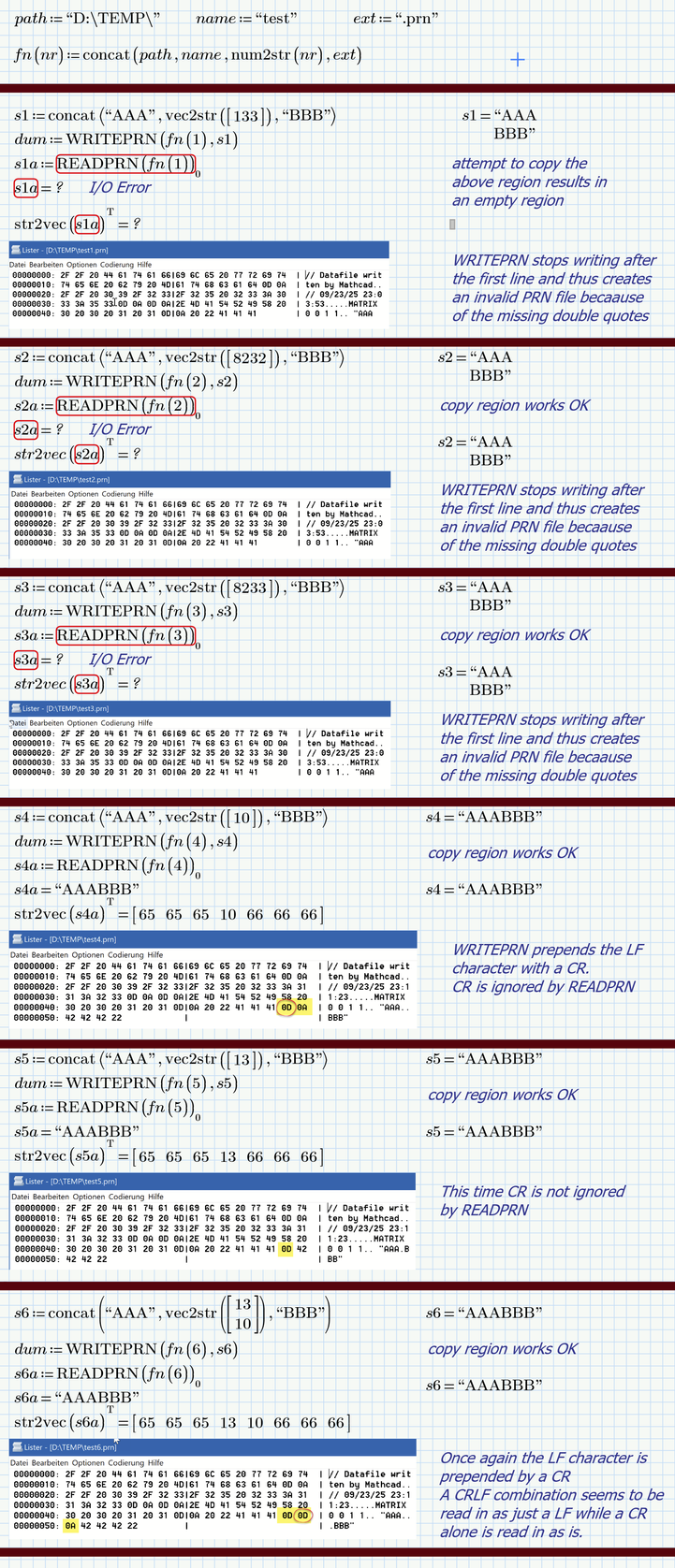

Works like a charm, also in previous Prime versions.
However, Mathcad will allow only codes up to 255, and produces an ellipsis "..." at the lower of the three:LucMeekes_0-1758660517254.png

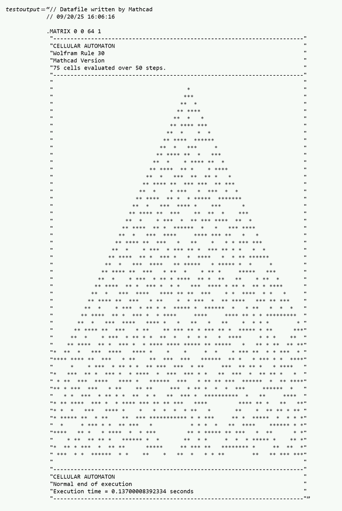

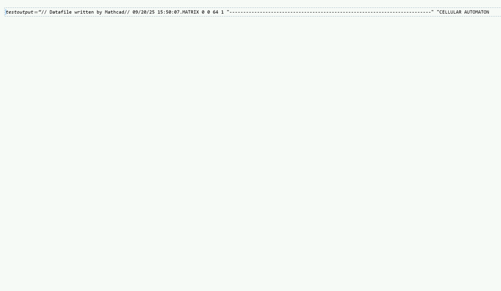

And another instance (worked in Prime 7, IIRC😞
Mathcad Prime 10:
Mathcad Prime 11:

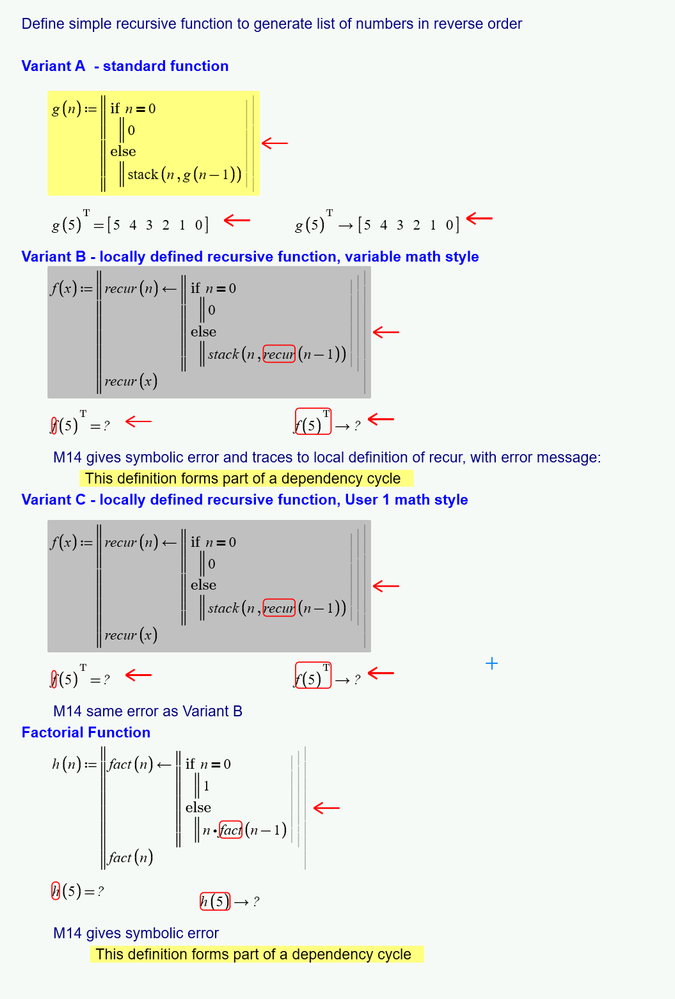

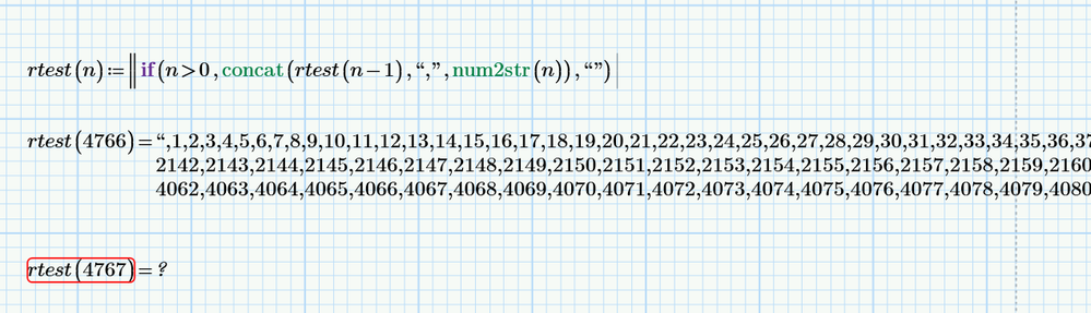

... Ah, yes.  A user complained that Mathcad crashed when running a recursive function that had no termination condition. So, instead of fixing the problem, Mathsoft added a recursion depth limit of around 4000, on the basis that who would ever want a recursion depth of more than that?  I mean, that would be silly.  Naturally, as one who regularly exceeded that depth, I whined like a whiny thing that had a special reason to whine (and I did have one).  The response?  Apparently, I could play with the Registry and set my own limit.
Again, I howled, pleaded, and wheedled to get a proper fix, using the pathetic excuse that setting Registry values wasn't exactly portable and many organisations forbade users (or anyone!) from playing with the Registry upon pain of termination; for monsters could be summoned if the mages cast an improper spell upon the Registry.  Would it not be better, I urged, to fix the problem by at least keeping an eye on the stack, and educating users on the need to write correct recursive programs?
Last I looked, the recursion depth limit was still there.  Yep, still there at 4766.  A very annoying limit (especially for those who use Express, which isn't exactly a selling point).
Heck, we haven't even got mutual recursion as a consolation prize.
Still, somebody must have noticed that I did actually use the Registry fix for recursion depth - see Scenario 1; if it's still in the Registry, I can't find it.

According to help:
vec2str(v)—Converts a vector of UNICODE codes in v to a string. This function also works with zero-length strings, such as vec2str(0) = "".
v is a vector of integers representing UNICODE code points for any valid string character. Acceptable values are integers in the range 9, 10, 13, or 32 - 255.
Indeed:
 Note that the argument to vec2str is NOT a vector of real numbers here.
And it seems to require that, except when the 'vector' is 0, instead of [0].:
(Value must be a vector of real numbers.)
ok:
but:
(String cannot be computed because it contains an invalid character.)
