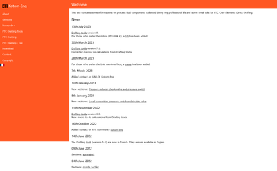

Thanks for your solution. This looks to be the best way for me to try.  The site (http://kotom.eng.free.fr) that you directed me to is not a secured site so I am  hesitant to go there. Also I havent been able to find 3D Access on any secured sites or even with Creo. I am I missing something here?
3D Access is not on my site.
My site is hosted on one of the 3rd major French internet provider Free (https://portail.free.fr/). Free allows free websites for his customers. It's poor and slow, but 100% free. You can be confident. Here is the index of my little website:
