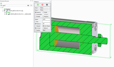

When we work machine elements like cylinder and piston. We need limiting the distance of two bodies.
Is there a way to limiting the distance in adv. design?

I need help limiting piston stroke between 0-40mm. File is attached. I tried to much from the help menu but I could not get it properly.
Thank you very much
I am not sure about the specifics of the case you presented so the modification I made are more intended to show the use of the IF THEN ELSE & Variable Check in Advanced Assembly.  Variable A is the distance the piston moves.  Vchk1 check to see if A is within the range of 0 to 40 otherwise it generates an error.
Thank you for attention but I just want to limit the stroke when I use position command.

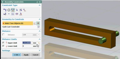

Sample video is below. NX has solved this years ago nicely.
https://www.youtube.com/watch?v=
QJ60SHLgNyI
How to use the new distance constraint with limits
