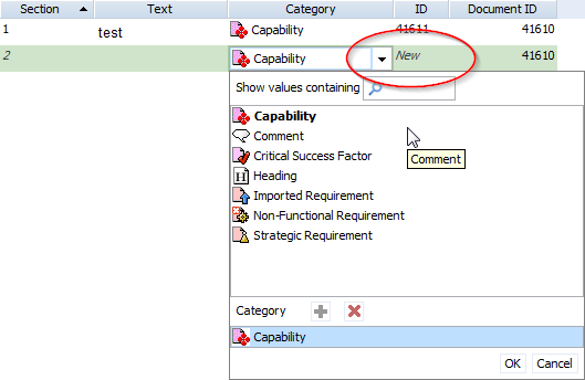

Now I assume, that when I have a Customer Input Document in the Recycle Bin project I can only see three categories (Capability, Comment, Heading), while in all other projects I see the full list. BUT: when I open a Customer Input Document in Recycle Bin I can still see the full list for the "New" item row:

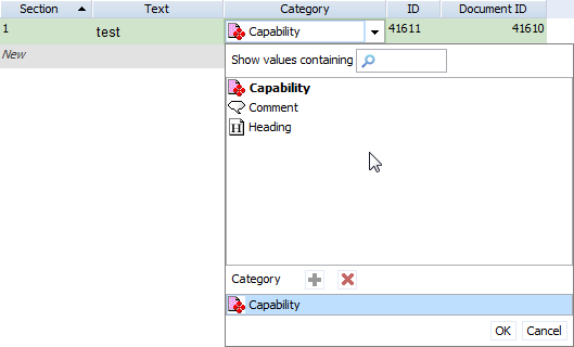

When I edit an existing item the pick list is shown as expected:
The reason must be, that the new item will be assigned to the project only when saving this item. Before it doesn't have a project. Anyway, is there any possiblity to hide the categories that are not allowed in this document?

You are correct in saying that the constraint will not apply to the Virtual Row fields because there are not yet any committed values in the database to check against. There are some submitted PTC Integrity Product Ideas which may match your request:
