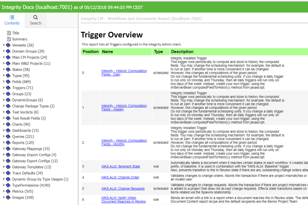

Creates a set of HTML pages documenting the PTC Integrity Lifecycle Manager configuration.
12.2: Created for Integrity 10.9/11.x/12.x and with full support of latest Firefox / Chrome / IE
IntegrityDocs exports the current Integrity Server configuration from W&D, and creates HTML pages. Each section under Workflows&Documents will become one node within the report tree. Each section starts with an "Overview" page, and then each element can be reviewed in more detail by drilling down.
