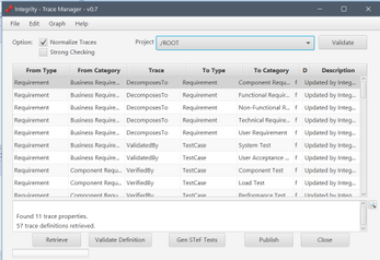

Topic #14
  • Tracing and Trace Definition
Use Case
  • As a user, I want that the system helps me to define the right traces.
  • As a user, I want that the system avoids creating traces to Headings and Comments.
  • As an administrator, I want an easy way to define the Alt-drag-drop functionality.
Best Practices
  • When defining the Alt-drag-drop functionality for Tracing, always include the category. This would avoid that someone creates traces between Headings, or Comments.
  • Activate a trigger that checks about any invalid tracing that a user might perform in the relationship fields itself. Again, check that only meaningful nodes will be traced.
  • Use the Trace Manager App to define and review the trace definition easily.
  • image
  • Use the Trace Manager App to create automatically the corresponding STeF tests. (see topic #10)

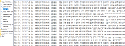

Topic #16
  • Standardized Custom Trigger Logging
Use Case
  • As a System Responsible, I want to get a standardized and consistent Trigger logging spooled to the server.log
Best Practice
  •  Develop a Trigger Framework, in Java, to standardize the Custom Trigger logging.
  •  Possible output might look like this:
  •  image

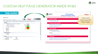

  •  Custom Help System
Use Case
  •  As a User, I want to have the possibility to access context - means type specific - specific help right out of the UI.
Best Practice
  •  Adapt the Presentation Template and add another link to a type specific html page.
  • This help page might be generated, with links in it to different other information sources, such as team help pages outside (e.g. sharepoint, standard help, templates, process descriptions etc.)
  •  We manage the links directly in a new item type.
  •  image

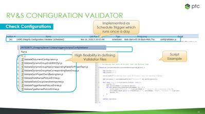

Topic #20
  •  Validate any system configuration frequently
Use Case
  •  As a system owner, I want to get automated support to check my own configuration rules.
Best Practice
  •  Use the Trigger Framework to define multiple validation tasks to check your configuration
  •  Define for each validation a single JavaScript file
  •  Execute the validations using dynamic script inclusion.
  •  Send an email about the validation results to the system owner daily.
  •  image
