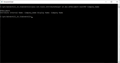

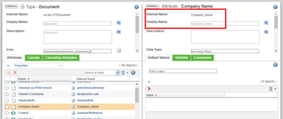

An easy way to do this that is completely independent of the attribute's datatype (String, Long, etc) is to use an sql query run from your Java class.
From Type and Attribute Manager we see Company Name.
If I pass my utility an attribute holder, such as a WTDocument, and the attribute's internal name the attribute's display name is returned.  Seems to work.
BTW, You need to navigate six tables in total from WTDocument or WTPart (or whatever class) to finally get the display value.
David
