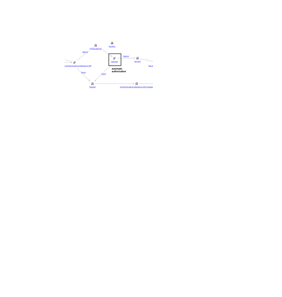

Within the workflow, the robot expresses how you are placing it? since I have the same detail that does not show me the process since I am putting the deadline.
