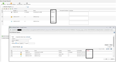

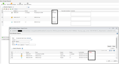

Can we filter by state or display state in 'Find Affected Objects' wizard when creating a CR?
RG_10753677
1. Can we display a state column in the Find Affected Objects window?
or
2. Can we add a filter and filter by state?
or
3. Can we use baseWhereClause="(state.state='PRODUCTION')" in jsp file and customize, so that only production state objects are returned?

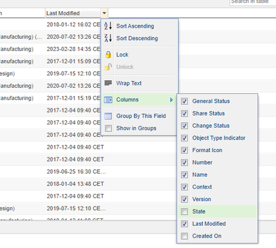

Hi @RG_10753677
Add the state to the view in a view customization
the state is already there so you need to just show it
PetrH
