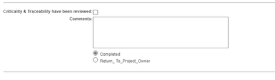

I have created the variable and check box is appearing as expected in the task page. there is this requirement where
there are 2 routing options, out of which for "Completed" routing option once selected  it should not complete the task  after clicking "Complete task" button until and unless the check box is selected. but where as the "Return_to_project_owner" routing option once selected even if the check box is not selected it should be allowed to complete the task.
till now I have this code in handy , which will not allow until the check box is selected but i wanted with routing option condition

I think you’re overthinking this.
All you need to do is put the code in the Complete transition and the code can be as simple as this.
if (!Criticalitycheck){
throw new Exception("To complete the task, Please select check box.");
